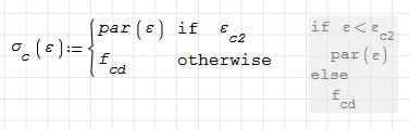

can someone help me to copy this mathcad code in a SMath's one?
I have some problems with the solution of Xn
Thank you
Hi. sigma.c fucntion is defined with an if clause. SMath can't integrate it, but you can use cases():
Now you can integrate:

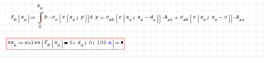

I made your correction, using the function cases(), but I have the same problem if I add other terms to fb(xn), for example if I add Ast*sigma sb(eps) and Asc*sigmasb(eps).
How is it possible?

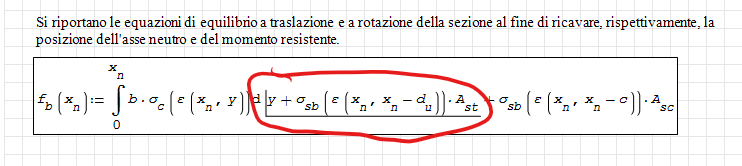

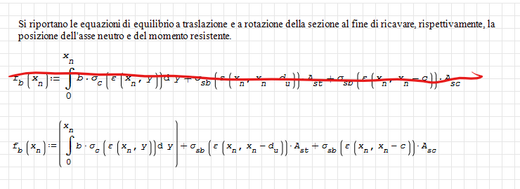

Possibly an odd bracket problem?
Here appears that Smath is making a group of "y+sigma bla bla" as object for the differential operator
So, fb(x) could not be evaluated.
I placed some brackets to clearly separate "y" from what follows in the equation, see picture below.
It appears that with brackets, fb(x) can be evaluated (but I get an error on units).

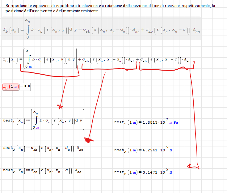

Splitted the equation in three contributions, it appears the the integral is not consistent with other two terms of the sum
I think calculation should work, once you clear the unit issue which is hidden somewhere in other parts of the calculation.

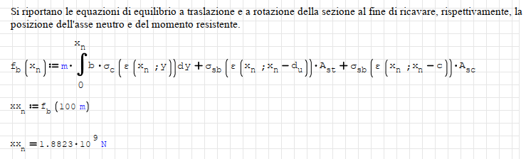

I am pretty sure my units mismatch correction is not suitable.
You should have to check this issue by yourself.
But I had managed to solve your function problem.
Rewriting it make function tick again.
verifica a flessione_prova2_rev.sm (45.02 KiB) downloaded 1379 time(s).

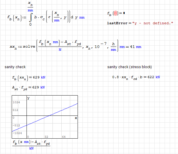

I've had this pending in background so I'll share the solution even here. Aside the initial issues about if() and units, the integral fails when x_n is set as 0, since epsilon is something/0. Therefore solve range must exclude 0 or the function has to handle it.
Happy Easter and take care, anyone.
