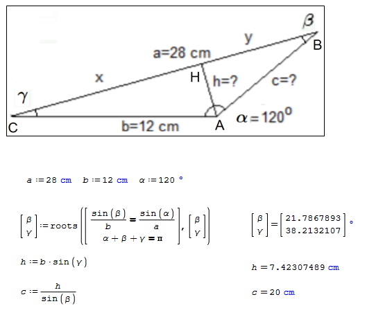

Do you know more simple method?
Natasha-Units.sm (147.18 KiB) downloaded 1613 time(s).

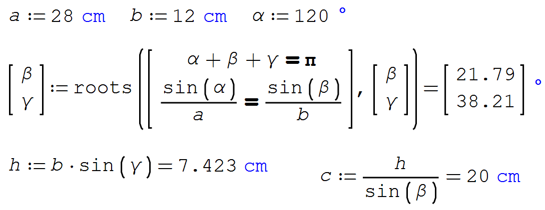

FindRoot() can be a simpler method.
You can auto assign guesses to unknowns.
And it can solve with units.
Natasha-Units_findroot.sm (114.03 KiB) downloaded 1615 time(s).

Here's a simple method:
