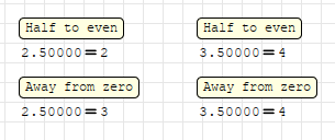

#2 Posted: 3/10/2021 8:46:04 PM
601 likes in 1,382 posts.
This is intentional.
Please pay attention to description.
Half to even, it is rounding to even number.
Even numbers are 2,4,6,8...
Odd numbers are 1,3,5,7...
If decimal part of number is even then it round downward to its base.
If decimal part of number is odd, it round upwards.
If you want always round to up when fraction is equal or bigger than .5;
You have to use away from zero rounding option.
https://en.wikipedia.org/wiki/Rounding#Round_half_to_even
#3 Posted: 3/10/2021 9:44:42 PM
Same with the round function, which leaves something like 2.5 becoming 2, not 3.
round() function when used with two parameters always do rounding with half to even.
If you want away from zero option in round() function, add third parameter and make it 1.
Regards.
