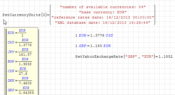

Hi all,
Here there is a plugin to have currencies and exchange rates in SMath Studio.
Infos:
Functions:
  • SetCurrencyUnits(1), SetCurrencyUnits(2): extends SMath Studio with currency units. When an internet connection is available, exchange rates are kept updated using the ECB reference rates (internet connection not required but useful);
    Quote
    The reference rates are usually updated by 3 p.m. C.E.T. They are based on a regular daily concertation procedure between central banks across Europe and worldwide, which normally takes place at 2.15 p.m. CET.
  • GetYahooExchangeRate(2): get a wide set of exchange rates from Yahoo Finance (internet connection required); service discontinued by Yahoo
>>> PLEASE REPORT IN THIS TOPIC ANY ISSUE, MORE DETAILED AS POSSIBLE <<<

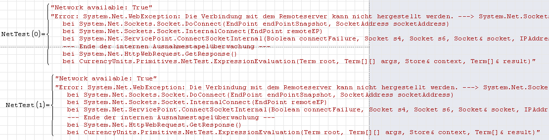

#4 Posted: 12/17/2013 3:23:36 AM
1,360 likes in 2,275 posts.
Better now, but still no connectivity. I guess that is sort of firewall or proxy issue.

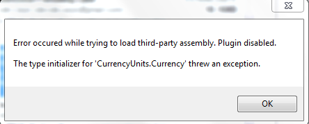

#5 Posted: 12/17/2013 6:00:17 AM
Unfortunately Davide, this does not work for me (Win7 x64). Plugin refuses to install properly.
#6 Posted: 12/17/2013 8:07:23 AM
ok... as for now the password is: TEST
Try again, I've made some changes... If doesn't work try NetTest(0) and NetTest(1) and post a screenshot
very strange... try again with this update; if doens't work got to %APPDATA%\SMath\Debug\CurrencyUnits and post the log file
#7 Posted: 12/17/2013 8:41:16 AM
The results were overly wide, thus i cut them.
#8 Posted: 12/17/2013 8:41:47 AM
Failed again

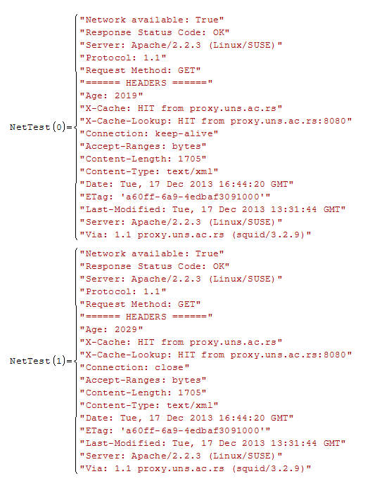

#9 Posted: 12/17/2013 11:09:29 AM
seems a proxy/firewall authorization problem... I suppose that NetTest("http://www.google.com") and NetTest("http://www.google.de") will produce the same results
Failed again
Here is the log file
I've made another little modification, could you try again?
#10 Posted: 12/17/2013 1:31:12 PM
It seems that this plugin is not going to install into the Martins' unofficial build. I figured out by the second line of the log file.
I tried it on the official one and it seems to be Ok
Davide Carpi 12/17/2013 1:50:00 PM
#11 Posted: 12/17/2013 1:52:02 PM
thank you Radovan, now I understand
the plugin looks for the files in the %APPDATA% folder, I'll try to fix it
[EDIT] UPDATED: this version should work properly both in the official and the unofficial versions
Radovan Omorjan 12/17/2013 3:08:00 PM
#12 Posted: 12/17/2013 3:08:09 PM
Yes it works, thank you

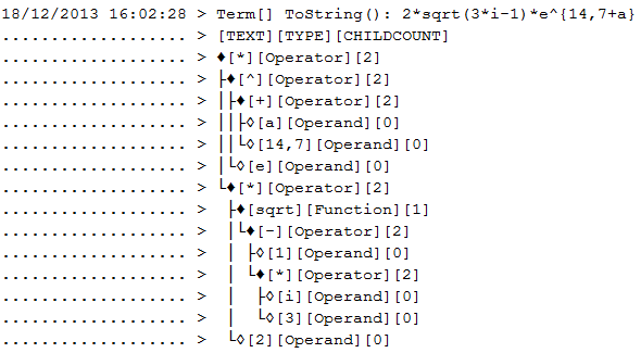

#14 Posted: 12/17/2013 10:14:35 PM
UPDATED
- error handling: LOGs will be placed in the relative "extensions\debug\CurrencyUnits" folder (so the portable version has a portable debug path)
- For developers only: added a log tool to output a Term[] tree representation (see the CurrencyUnits Implementer.cs).
2013-12-18 17_05_51-C__Users_Davide_AppData_Roaming_SMath_extensions_debug_CurrencyUnits_log.txt - N.png
