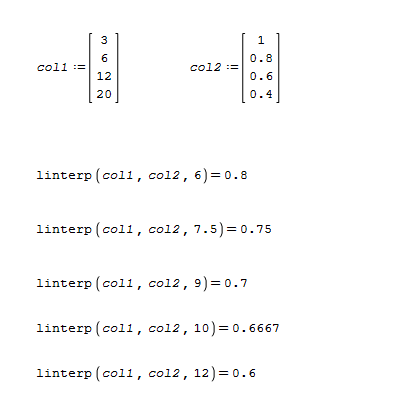

Coming with a new challenge.
I have the table below, based on a value from this list: 3,4.5, 6,7.5,9,10.5,12,14,16,18,20 i have to do interpolation to find the value from collumn 2.
So for 6 i have 0.8. but for 7.5,9.10, i need to do interpolation.

You can do that by a linear interpolation:

This is perfect, thank you very much. It was so simple i was looking into something a bit more complicated.
