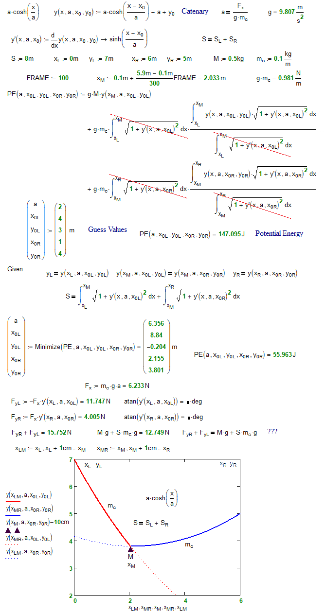

SMath Forum SMath Studio Questions Catenary with mass 1 Pages (1 items) Catenary with mass - How we can solve it in SMath - Messages Go to last post #1 Posted: 12/10/2025 6:22:25 AM Valery Ochkov 66 likes in 697 posts. Group: User Is the model correct? is a.L equal a.R? Can we insert the 5-th equation an use the Find/Roots function?Why the Forces calculation is not correct?cable-car.xmcd (122.9 KiB) downloaded 800 time(s). Edited 12/10/2025 9:58:47 AM 1 Pages (1 items) New Posts No New Posts
