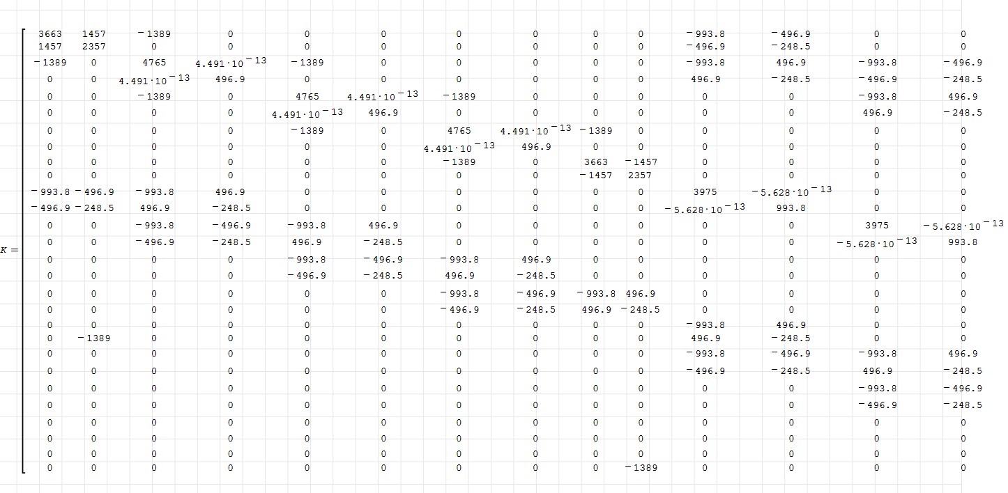

Thanks, Alvaro. I've attached a screenshot of part of the K matrix in case that will spark any thoughts, but not sure if that will be helpful. I could upload the .sm file as well if that would be easier.
When you say one of the versions, you mean 'K^-1 =' vs 'Kinv = K^-1; Kinv = '. If it was a condition number problem, would you expect that to show up simply because we've defined a variable rather than evaluating without a new variable definition? I'm just specifically confused as to why:
K^-1 = one answer
Kinv = K^-1; Kinv = a different answer.
Is something happening related to the condition number when saving the inverse as a variable that doesn't happen when evaluating directly?
Thanks again for your thoughts.

Hi. Condition numbers are for check if a problem involving some matrix is a problem with a low condition number is said to be well-conditioned, while a problem with a high condition number is said to be ill-conditioned. What the inverse() SMath's function do is a numerical procedure, not a symbolic matrix inversion. So, it could have a lot of different issues. This are the available condition numbers in Mathcad. If you attach the smath dile someone here can tell you more about. Notice that there are some plugins that have the matrix inversion procedures too. For instance dn_MatrixInverse, but there are others, I think.
What I say about eval() is about an SMath function that make some round-up and truncation errors. In your case you need to check if you get the same different result with KK := submatrix(K,1,20,1,20) and KK := eval( submatrix(K,1,20,1,20) )
Finally, your K matrix is of the type 'sparce'. Some programs can detect that and use some specific algorithms for such cases, like matlab.
PD. Perhaps the condition number requires some explanation. Suppose you solved a purely resistive electrical circuit by direct calculation, either nodes or meshes. If you see it from a simple theoretical point of view, you could have used Kramer's rule to solve it, since it is a linear system. And you know well that for there to be a unique solution, the determinant of the matrix of the system has to be different from zero. But we are talking about a real circuit. And the resistors are not exact, they come with a 10% error, for example. So how do I know if the circuit I designed is going to be stable or a mess? You justify by calculating some of the condition numbers to the system matrix. So you say that the problem you solved is well conditioned because you got a low value for that number, which is going to indicate that there are going to be no problems using that matrix in a linear system. That is, you never provide only one solution to a practical problem. You also have to study its stability. Condition numbers are suitable for linear systems with matrices. For differential equations there are also methods to study the stability of the proposed solutions.

Hi David,
From my point of view, your matrix looks like a stiffness matrix from a Finite Elements Method approach, if that is the case, I was working on that some time ago, and I found some issues trying to solve the equation [x]=[K]^-1*[F]. My solution was to use Gauss elimination or a solver for a banded version of [K].
Anyway, as mention Alvaro, it would be great if you attach your .sm file to check it.
