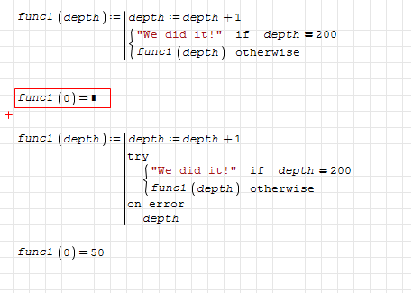

To better illustrate what I think is happening I've created the following worksheet. The first function definition is just a simple function that calls itself recursively until its 200th call at which point it exits. However, when run it experiences the same error as we see in the sudoku.sm. I rewrote the function using a try/on error and we see we only get to 50 iterations before it fails.

What I understood considering your last messages, you think there is nothing significant wrong with the code itself. Problem is SMath handling of recursions.
So, it comes forward that is why I wouldn't be able to make an SMath Sudoku Solver with recursion.

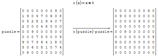

I think it's possible to fill the '0' positions of the 9x9 Sudoku
with random not common to the existing filled position.
Filling one col at time, collect ...

I remember this limitation was introduced some time ago to avoid unintentional hard crashes on wrong formed algorithms; considering that any recursive algorithm can be made iterative, you probably have to design it in another way or find a different code

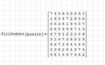

Well it works for the first two puzzles at least. Having issues with the third. Haven't tried the fourth....
It works for the fourth, but fails for the third puzzle.
