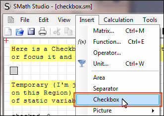

#4 Posted: 1/11/2012 5:31:59 AM
2,342 likes in 4,041 posts.
Yes, this is something apart from Area.
I've prepared some files for you to play with it:
  1. Download Checkbox Plugin and put it to plugins folder of the installation directory of SMath Studio.
  2. Run SMath Studio and find the Checkbox item in the Insert menu.
  3. Download and open the example .sm file for quick start.
Is an alternative way to program plugins without visualStudio?
Visual Studio is the easiest way to create plugins.
Regards.

#6 Posted: 1/12/2012 4:31:11 AM
Clicking it turns it from solid filled to empty filled but how do I associate with some value.
Variable "checked" is hard-coded for this component for now (I will improve this plugin later). So, clicking on it will change value of this "checked" field from "0" to "1" and vise versa. I've shown it in the attached to my previous comment example.
