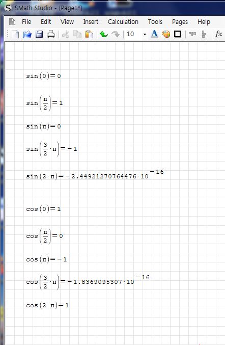

Hello.
I find buf for sine and cosine functions.
Ex.) sin(2*pi)=-2.4492170e-16
cos(3/2*pi)=-1.83690e-16
Check please.
Thanks in advanced.

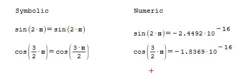

#2 Posted: 3/17/2018 11:30:59 AM
There is no bug: sin(2pi)=0

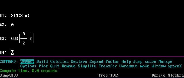

For example, it invalidate my favorite integer question function:
which I use from Derive for DOS, who knows the exact answer:
