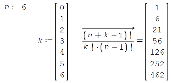

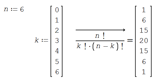

#1 Posted: 6/19/2023 11:38:40 AM
Valery Ochkov
Valery Ochkov
67 likes in 716 posts.

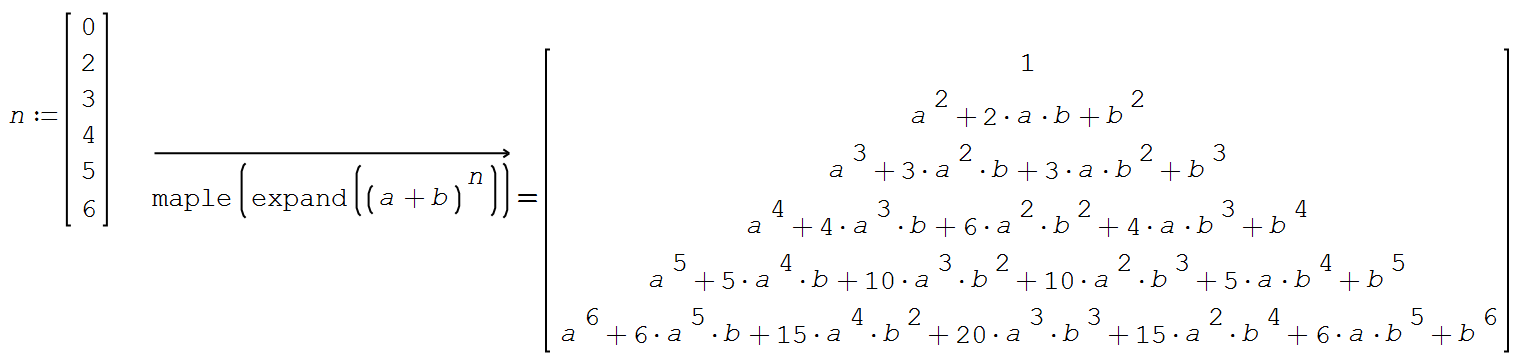

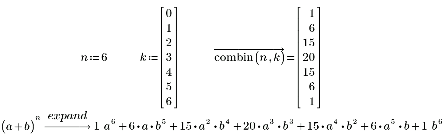

Can I do this with SMath/
See please Mathcad

I know how create the first part. Has SMath the expand operator or some one?

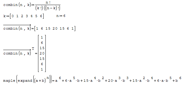

#3 Posted: 6/19/2023 12:21:12 PM
Can I do this with SMath ?
Smath offers more.
Maths Combine.sm (76.61 KiB) downloaded 1357 time(s).

#4 Posted: 6/19/2023 12:31:09 PM
Valery Ochkov
Valery Ochkov
Smath offers more.
Thanks!
But this
#5 Posted: 6/19/2023 12:32:28 PM

Can I have the combin from Maple?
#7 Posted: 6/19/2023 12:40:56 PM
Your two demands honored.
#8 Posted: 6/19/2023 12:55:47 PM
Valery Ochkov
Valery Ochkov
Pascal triangle

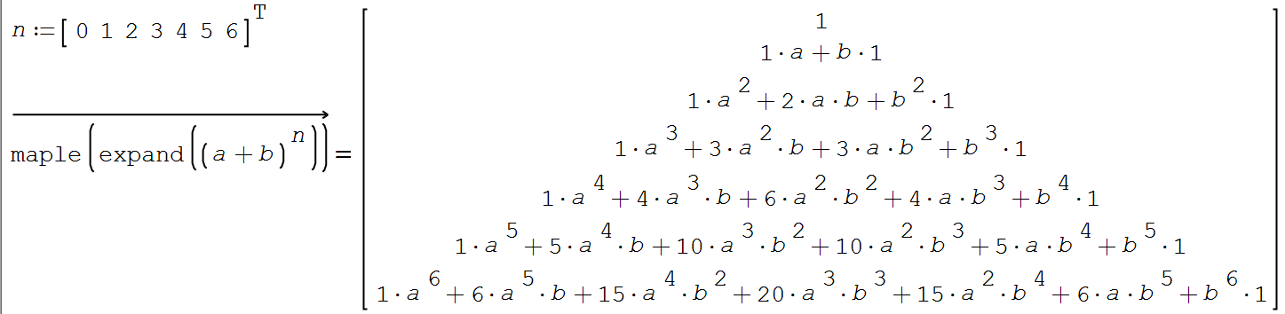

#10 Posted: 6/19/2023 6:23:49 PM
Pascal triangle
Maths Pascal Triangle QUICK.sm (48.15 KiB) downloaded 1323 time(s).

#11 Posted: 6/20/2023 12:17:21 AM
Valery Ochkov
Valery Ochkov
Pascal triangle

#14 Posted: 6/21/2023 11:41:59 AM
Pascal triangle
Fully automated.
Maths Pascal Auto Companion Copy.sm (36.62 KiB) downloaded 1296 time(s).

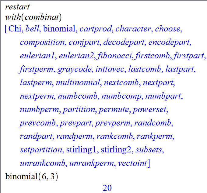

#17 Posted: 6/21/2023 4:06:18 PM
1,558 likes in 1,868 posts.
Usually, when working with Maple, you need to specify the name of the used package using the with() keyword.
To simplify the work with the maple() function, I make an indication of the packages used implicitly. When calling a function, a certain set of packages is always added.
These packages are listed as commands in the with.inc file. This text file is located in the Maple Tools plugin folder. In one of the subfolders (it seems bin).
You need to add the following text to the contents of the file:
with(combinat):
After adding this line, it will be possible to call functions from this package.

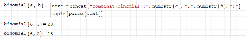

The function can be called like this
#20 Posted: 6/22/2023 10:49:51 AM
How do you add this to the plugin? Could you show this ?
Does binomial work on your system ?
Maths Pascal Auto Companion QUICK.sm (4.89 KiB) downloaded 1316 time(s).
