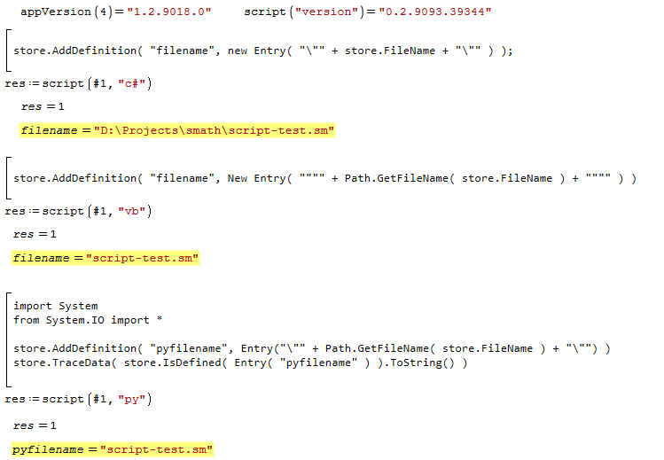

As a temporary solution, I decided to add a function that can execute text scripts. Unfortunately, I can't build a working plugin on the server, so for now I'm just showing how it will work.

overlord, is there any way you have found to run python scripts under Smath Mono Linux?
