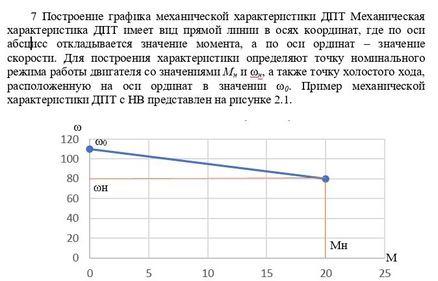

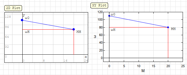

Hello.
Tell me, please, if I have two points, then how can I plot a graph between them? According to my assignment, I need to build several graphs, but I do not know how to do it in the program. I have done the calculations, but for the rest I ask for help from local experts. I attach a sheet with the task and a file with calculations (sorry, that's in Russian). Can someone help me figure it out here?
DPT s NV.sm (19.52 KiB) downloaded 1348 time(s).
Mekhanicheskie kharakteristiki DPT s nezavisimym vozbuzhdeniem.docx (95.56 KiB) downloaded 693 time(s).

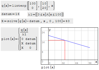

I made a sample with two different plots.
You can use them by changing variables.
DPT_NV plot.sm (11.08 KiB) downloaded 1315 time(s).

TwoPointsPlot.sm (11.84 KiB) downloaded 1291 time(s).

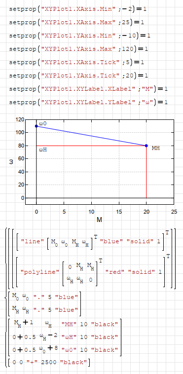

#6 Posted: 2/26/2023 9:21:08 PM
You can also use line and polyline commands for plot.
They work only in XYPlot, but sometimes they make everything easy.
There is also a setprop() function.
It can change format of your XYPlot automatically.
Search setprop() in forum for further information.
DPT_NV plot.sm (20.47 KiB) downloaded 1476 time(s).

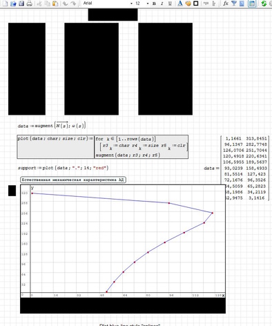

Thanks to everyone. The first answer helped me enough)
One more question:
if I have a graph (attached file), then how do I mark the points along which it passes?
I tried: vector M(s) ω(s) "." 15 "blue"
but the application immediately crashes.
AD.sm (20.17 KiB) downloaded 1271 time(s).
Is it possible to make the graph automatically scale to the new values?
And does someone use android version of Smath (from this site)? I can't edit any of these files there.
One more question:
#8 Posted: 2/27/2023 8:47:08 AM
WroteIf I have a graph (attached file), then how do I mark the points along which it passes?
As in the attached.
Instead of re-scaling the same graph, plots all new graph on the same plot.
You will scale to accommodate for the larger graph.
AD Plot Points.sm (104.39 KiB) downloaded 1355 time(s).
TopUser2000 2/27/2023 3:08:00 PM
#9 Posted: 2/27/2023 11:29:43 AM
#10 Posted: 2/27/2023 1:38:10 PM
WroteIs there any simple way to add the pass points and autoscale a graph?
Some Smath versions decided that opening in other versions will be black.
1. Open this document
2. If black, select by groups, click on background white
3. Make the all document as per 2. directive
4. at this point, you have recovered my original
5. Plot points and more advanced.
AD Plot Points TopUser2000.sm (87.24 KiB) downloaded 1283 time(s).

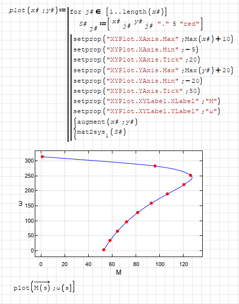

#11 Posted: 2/27/2023 1:57:37 PM
You can use this, XYPlot region is suitable.
One custom function to plot everything.
It also autoscale the graph.
AD.sm (28.23 KiB) downloaded 1248 time(s).

setprop() - функция устанавливает свойство компонента. Возвращает 1, если свойство найдено и успешно установлено, иначе 0.
Она ищет компоненты на всех листах с указанным именем и меняет указанное свойство. Набор доступных для изменения свойств ограничен.
Точки также можно включить в свойствах кривой. ПКМ на компоненте и выбрать настройки, далее зайти в свойства кривой и там выбрать тип маркеров вместо пустого.
В компоненте XYPlot нет автомасштаба, поэтому пока так.

Download first document @ post 10 ... let's see if it works ?

Now it works but anyway this way is too difficult for me

If you just have some experimental points you can't escape Hermite.
It was used long time ago for Mollier.
Hermite cubic interpolation is more ancient than my Mathcad 8 Pro.
