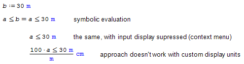

#3 Posted: 1/23/2021 5:56:50 AM
127 likes in 342 posts.
it's just a cosmetic solution
disuguaglianze.sm (5.31 KiB) downloaded 1054 time(s).

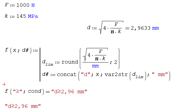

#4 Posted: 1/23/2021 11:14:58 AM
1,357 likes in 2,271 posts.
A very limited native solution
Blatt2.sm (4.65 KiB) downloaded 1097 time(s).
