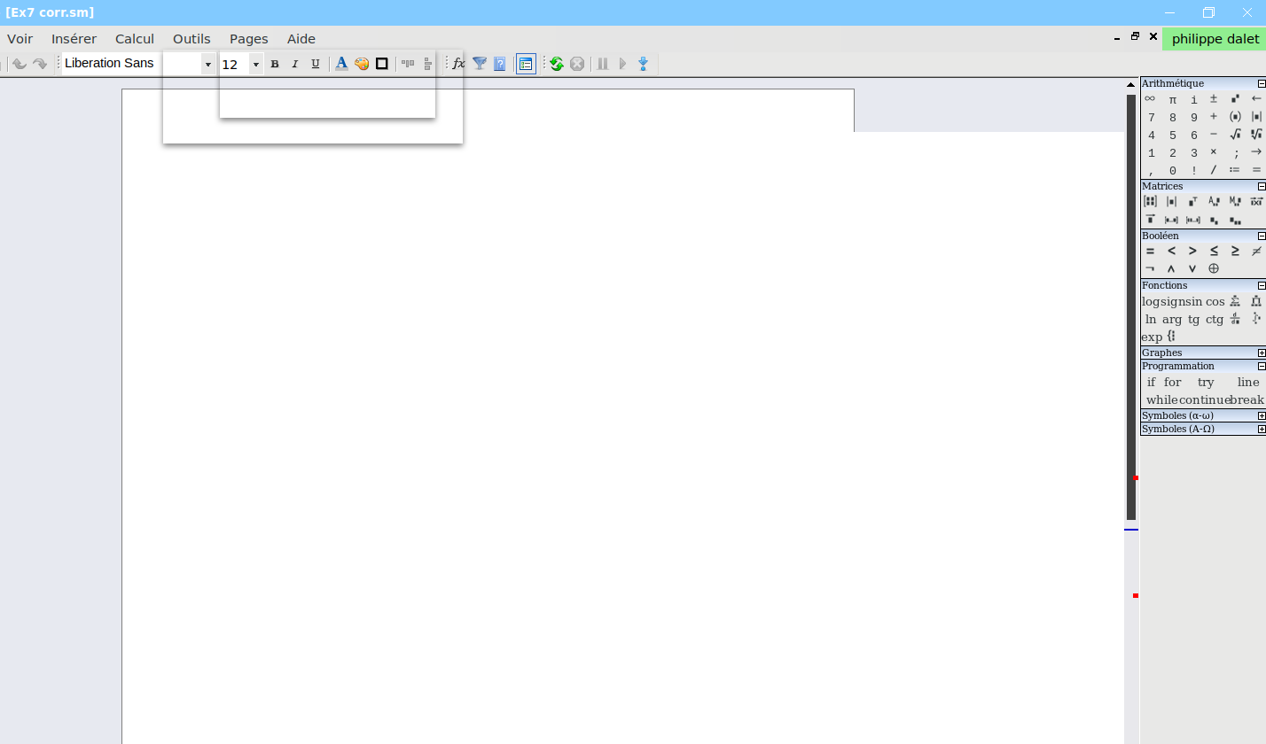

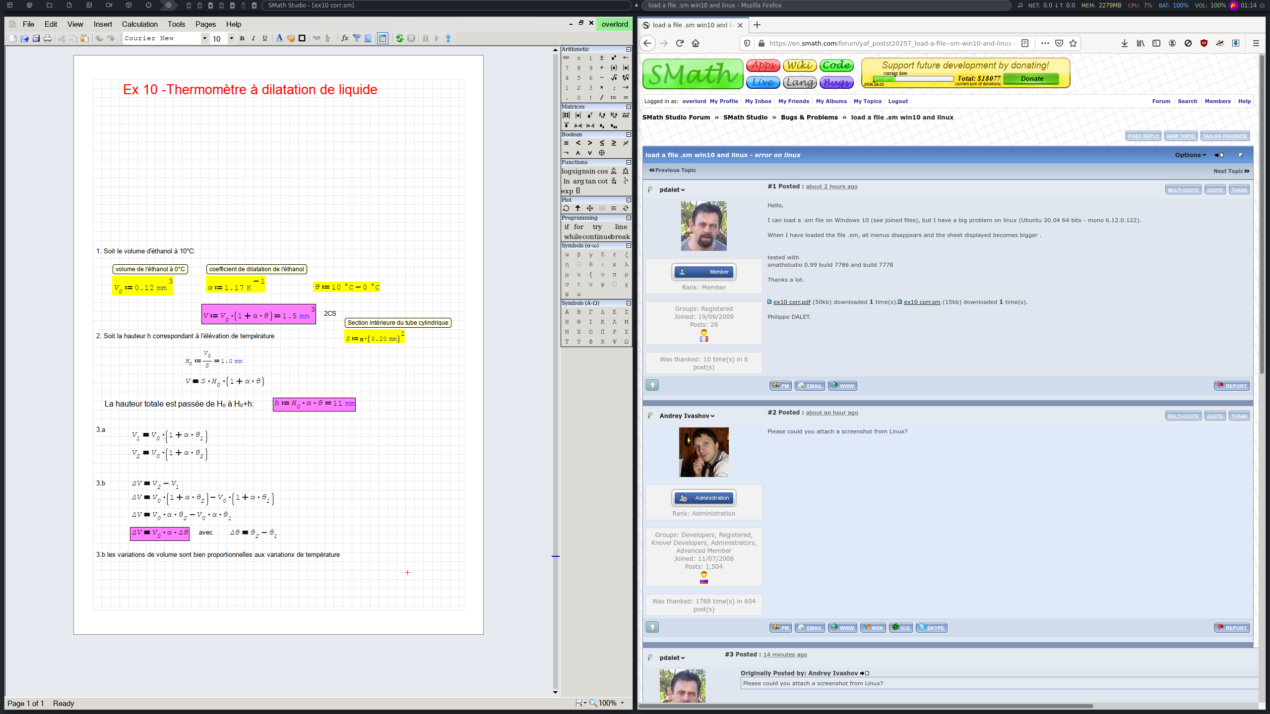

I can load a .sm file on Windows 10 (see joined files), but I have a big problem on linux (Ubuntu 20.04 64 bits - mono 6.12.0.122).
When I have loaded the file .sm, all menus disappears and the sheet displayed becomes bigger .
tested with
smathstudio 0.99 build 7786 and build 7778
Thanks a lot.

Please could you attach a screenshot from Linux?
#3 Posted: 4/26/2021 6:59:21 PM
philippe
Andrey Ivashov 4/26/2021 7:42:00 PM
#4 Posted: 4/26/2021 7:15:06 PM

#5 Posted: 4/26/2021 7:42:52 PM
2,345 likes in 4,059 posts.
Thank you. Will check this issue.

The file is a correction of a physical problem given to my students.
