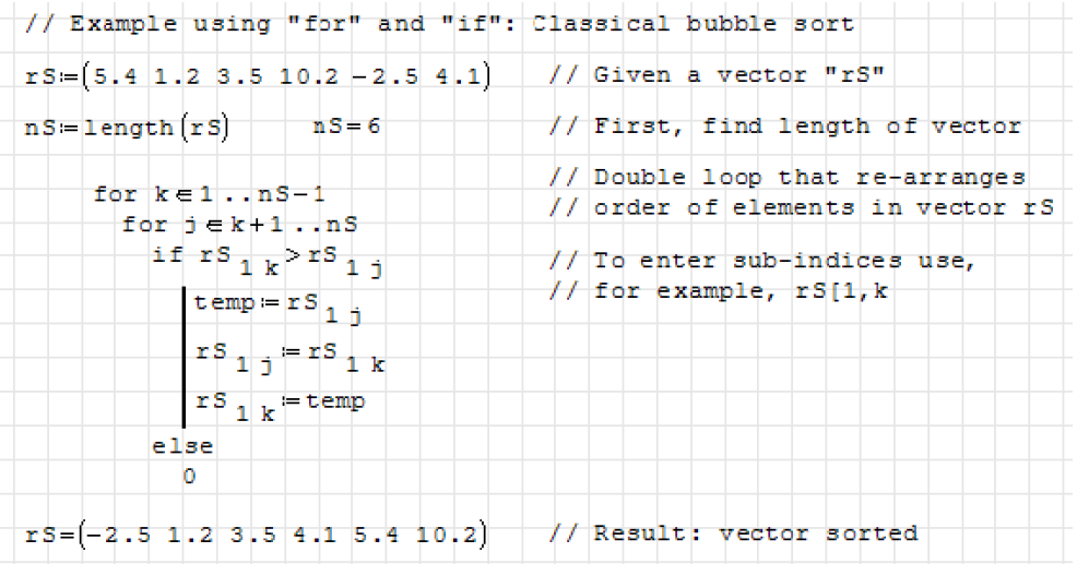

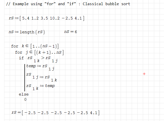

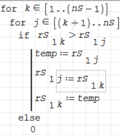

SMath Forum SMath Studio Questions for if state 1 Pages (2 items) for if state - Messages Go to last post #1 Posted: 5/26/2023 5:19:30 AM soomoon 1 likes in 42 posts. Group: User I am studying with Introduction to the use of SMath Studio Prepared by Gilberto E. Urroz, May 2010.but i try to this, result isrS=mat(-2.5,-2.5,-2.5,-2.5,-2.5,4.1,1,6)what is problem? #2 Posted: 5/26/2023 6:07:34 AM Alvaro 1,124 likes in 1,796 posts. Group: User Hi. You have j := rS[k,1]Best regards.Alvaro 1 Pages (2 items) New Posts No New Posts
