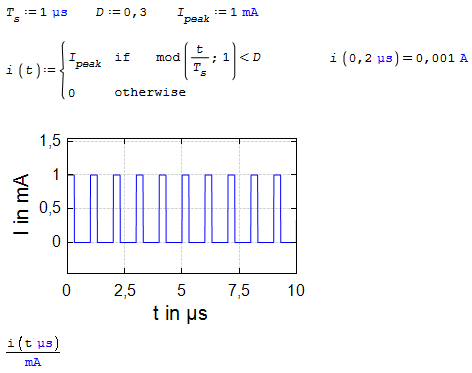

Please see the attached example in MC15 that I cannot seem to get past the first graph of creating current pulses, thus can't move forward attempting to address the actual circuit analysis. The constant current pulses creating the resulting voltage waveform is the goal.
I welcome any suggestions/recommendations to convert the MC scheme to SMATH Studio.

The function is defined using the cases() function from the Customfunctions plugin.

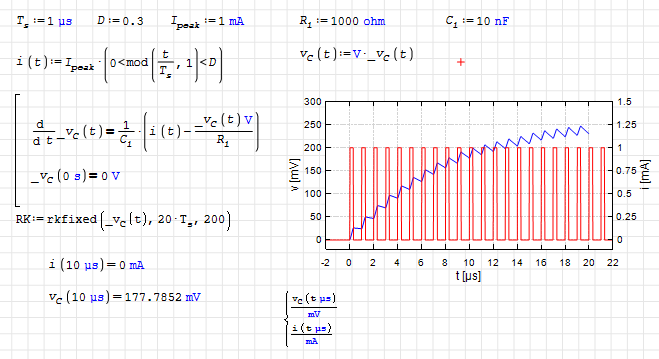

Thanks to Martin, I was able to move forward! R-C Network.sm (24.21 KiB) downloaded 1606 time(s).

Hi. This could be another option.

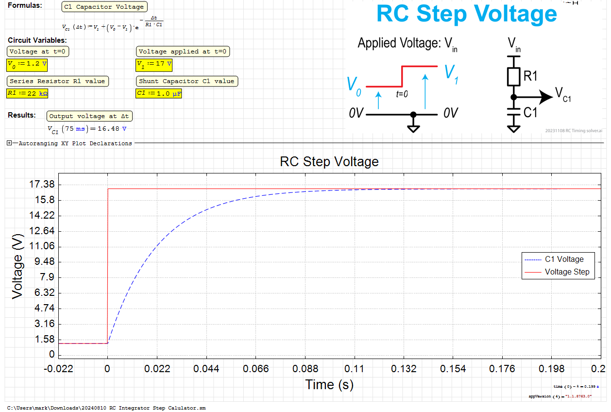

20240810 RC Integrator Step Calulator.sm (74.45 KiB) downloaded 1643 time(s).
