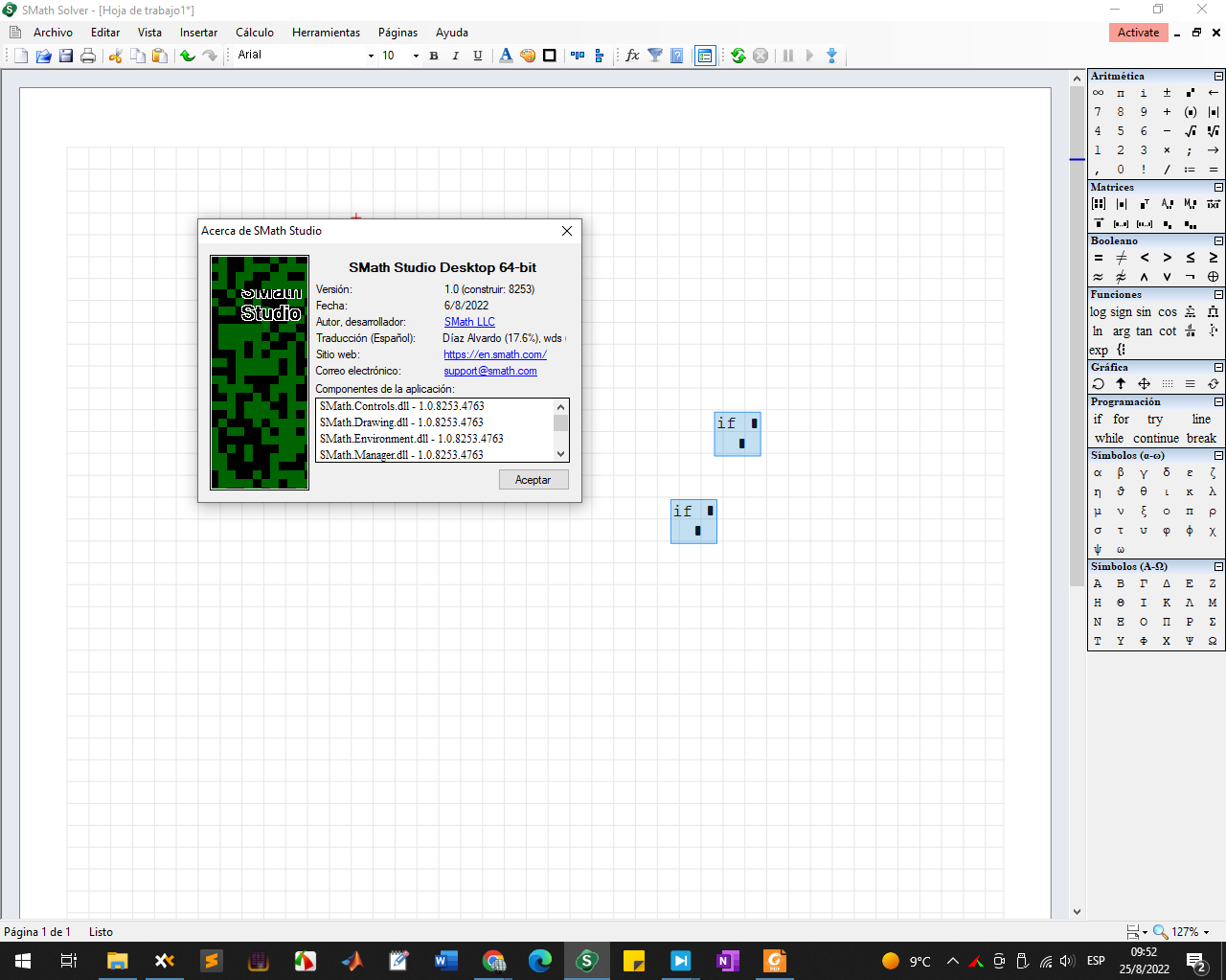

Dears,
I would like to ask you how the if then else control statement is used in SMath Studio version 1.0 8253.
When I insert the if statement, the else does not appear. How is it incorporated? I saw in videos that when placing the if statement both appear, the complete if x else x statement. In the version I use, only the if appears.

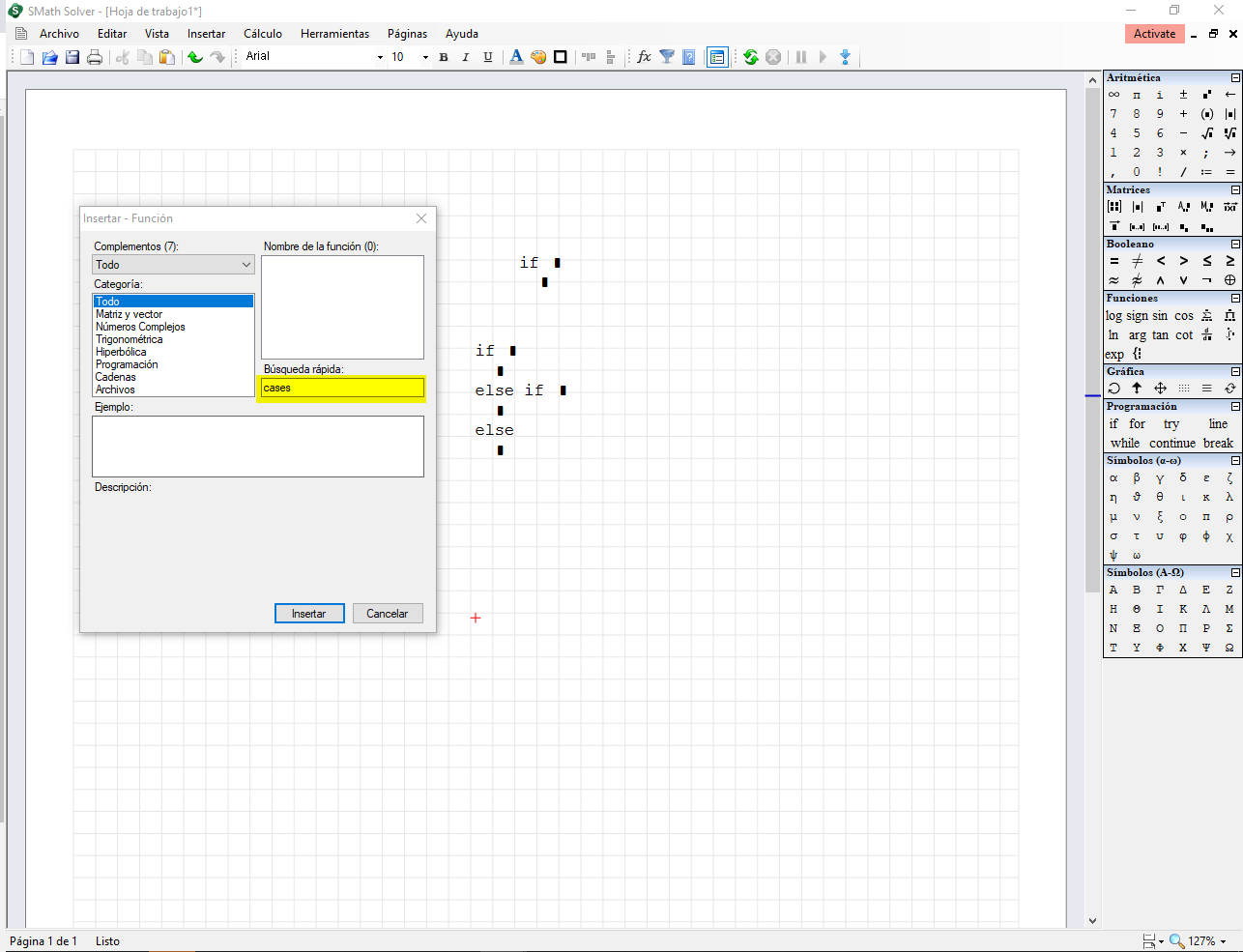

Another query, ¿in which plugin is the CAUSES() statement, which is an if then else version to generate functions by sections (piecewise function)?.

if/otherwise from the f(x) menu ... cases
if/else from the palette.

He doesn't use latest version. In fact, he uses 6 year old version of smath (v0.99.6179).
The version he uses has not capability of "if, if/else". That has only "if/else". New function is intruduced with v1.0.8206.

cases() is a plugin function. It works similar to if/else. You need to install Custom Functions plugin.
