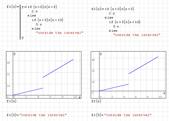

Newbie question :
How can I define a function by different expressions on various intervals ?
In Mathcad, the way to create the vertical line is either the square bracket, or go to 'add line'
from the 'programming' toolbar.
#2 Posted: 4/8/2011 4:06:56 AM
In SMath is the same. Did you try it?
Here are the examples of making piecewise functions.
The lines are not connected - it is due to choosing "Graph by points" from the "Plot" side panel.
Try "Graph by lines" to see the difference.
Btw, pay attention that a logical expression like x < y < z iz not working in SMath like in Mathcad.
[MATH=eng]5<4<6=1[/MATH]
Use parenthesis when mixing logical and relational operators and in the case you are not sure about the operator precedence.

Radovan,
Does this only work with 0.89.8 beta?
I duplicate what you've done but get no graph. Says f2([]) not defined.
Ed
#4 Posted: 4/8/2011 1:11:14 PM
Yes Ed - it seems you are right. I did this in v.0.89.8 but in v0.89 the f2(x) function does not work in the graph (not defined...), as you explained.
I do not know the reason, just guessing that Andrey fixed that in the 0.89.8 version.
