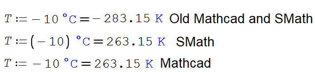

#1 Posted: 4/30/2023 3:55:23 PM

Greetings,
It is important to note that temperature is a variable unit in SMath and not a function as it is in Mathcad.
Regardless, the first line is converting 10°C --> 283.15K; and then applying the unary operator of minus (-) to the value; thus: -283.15K; Make sure you apply the unit °C to -10 and not just 10; use the space bar to group your operations correctly.
When in doubt: use parenthesis for grouping your operations.
May this be of Good Help,
- SK Kenny Lemens, P.E. ᵂᴵ

#6 Posted: 5/1/2023 4:13:13 PM
1,362 likes in 2,276 posts.
This issue is constantly confusing new users. The evil is in the design decision that the unary minus has the same priority as the binary plus and minus, both are less than multiply and divide. This is counter-intuitive. So you have to use parentesis in SMath where you would not expect to need them with pencil and paper. Changing these priority rules might fix the problem (and perhaps cause other ones).

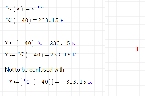

#11 Posted: 2/20/2024 11:12:54 PM
600 likes in 1,381 posts.
I put my negativ temp like t2=(-43), ant t1=20, all in degC
Now I got this in Smath editor
t1-t2 = 63K it is OK
but t1-t2 = -210,15degC
it works like this: t1-t2 = ((20+273) - (-43 + 273) - 273) = -210,15degC THIS IS WRONG. there should not be extra (-273) on the end when you enter degC in the placeholder of expresion for convert from K to degC
What is right
t1-t2 = 20-(-43) = 63degC
t1-t2 = (20+273) - (-43+273) = 63K
Difference deltaT/deltat do not depend of scale (for degC and K for sure)
so definitely there is a bug in conversion (adlist when conversion is done by manipulating placeholder behind result)
This is not a bug, this is how SMath works.
You have to use delta temperatures for that kind of calculations.
Unfortunately there is no easier way.
If you really need to calculate without delta temperatures,
You can use a custom equation/function like this.
