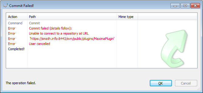

It seems that the link to the svn repository has changed.
Doing svn update made my svn client (tortoise svn) aware of that.
Still the commit fails.
Any hints how I can proceed?

Perhaps that was just bad timing, now the access works with the previous credencials.
BTW, nice change!
#3 Posted: 8/9/2017 11:25:26 AM
SSL certificates expired some days ago, since Andrey has renewed them you have to login again (data transfers must be encrypted with new signatures)
