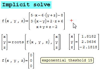

#2 Posted: 8/23/2017 7:15:13 AM
There are more ways exemplified in the attached Smath.
Setup the system in traditional format, the solving
algebra follows ... Universal. Same approach will
optimize a data set for polynomial best fit.
Cheers, Jean

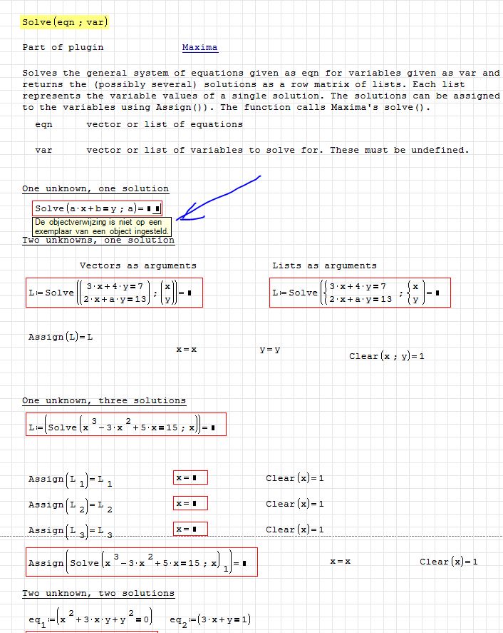

#3 Posted: 8/23/2017 7:31:09 AM
The Solve function from the Maxima Plugin finds symbolic solutions, equations can be non-linear and involve units.
The attached file is taken from the interactive handbook (available in the extension manager).
_Solve.sm (35.8 KiB) downloaded 1466 time(s).

#5 Posted: 8/23/2017 6:32:45 PM
Many Thanks for the help sofar. I downloaded v14 + maxima en try to use the solve function, but I got the message as displayed in the enclosed file:
Translation of Dutch message: The reference of the object is not adjusted to an item of the object
What can be the problem ?
Another question: the solve option under the Calculation tab is grayed out. It seems I can not use this solve option. What can be the point ??

#6 Posted: 8/23/2017 7:34:02 PM
WroteMany Thanks for the help sofar. I downloaded v14 + maxima en try to use the solve function, but I got the message as displayed in the enclosed file:
What can be the problem ?![]()
What is v14? I recommend to use the latest nightly build of SMath and Maxima, see http://en.smath.info/forum/yaf_postsm11095_Maxima-Plugin.aspx#post11095.

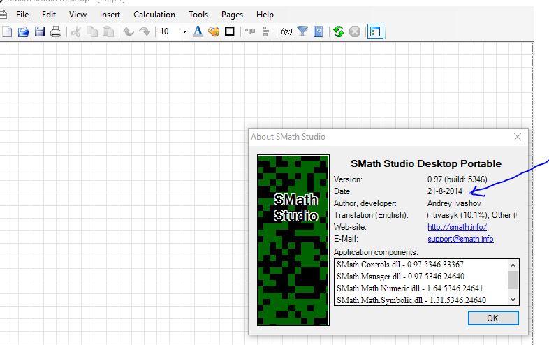

#7 Posted: 8/24/2017 4:53:03 PM
I use version 14 as is visible in :
I use windows 10 . Can that be the problem.
Do I have to do some installation settings to get maxima running ?

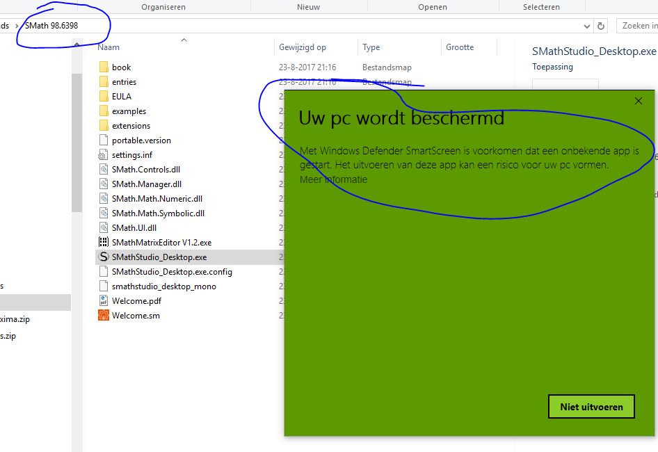

#13 Posted: 8/25/2017 5:05:10 PM
The only change I did to the executable was to set the 32 bit flag which is required for the Mathcad user library interface to work (Steamtables and Special math functions libs, userefi plugin). If you don't need this, then replace the executable in the portable distribution by the one in the LINUX version (yes, even if you are under win).
If that doesn't work you can still try the installation procedure described in http://en.smath.info/forum/yaf_postst2078_Maxima-Plugin.aspx. This exclusively uses original installers.
#14 Posted: 8/25/2017 5:08:19 PM
Do you mean: you couldn't download none of the
work sheet I attached ? Strange Smath does not
start. Try to call from the icon in the Smath
main directory.
