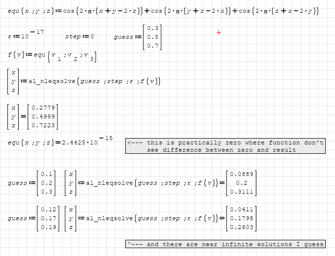

More experienced users may help you better than me.
But your equation seems to have infinite solutions.
al_nleqsolve equ(x,y,z).sm (10.75 KiB) downloaded 1220 time(s).

As overlord points, there are infinite solutions. Just like the better visual representation for z = f(x,y) is a surface in the 3D space, w = f(x,y,z) is a hypersurface in the 4D space. But we can't see that plot. So, here a plot of families of that 4D hypersurface, like a contour plot, but with surfaces.
About Dragilev method, I can't find my setup for 3D, and the expert there is Viacheslav (uni).
Plots4D.sm (111.28 KiB) downloaded 1289 time(s).

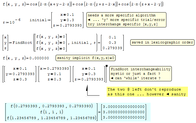

#6 Posted: 7/6/2021 3:05:22 AM
Well, Fridel it's an expert too, thanks.
Joining above Dragilev and 4D methods.
Plots4D_DM3.sm (111.83 KiB) downloaded 1250 time(s).
Plots4D_DM3.pdf (182.28 KiB) downloaded 780 time(s).
