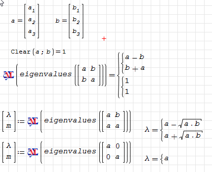

SMath Forum SMath Studio Questions eigenvalues error 1 Pages (2 items) eigenvalues error - Messages Go to last post #1 Posted: 12/11/2023 5:03:30 PM soomoon 1 likes in 42 posts. Group: User i'm studying SMath with Maxima (written by Dr. Kraska)but i did not get the result.my result is this.smath with maxima.sm (94.66 KiB) downloaded 1412 time(s).thank you in advance #2 Posted: 12/11/2023 11:27:17 PM Martin Kraska 1,359 likes in 2,273 posts. Group: Moderator You have to clear the values of a and b. These must be scalar variables, in your sheet these are vectors. Technische Mechanik mit SMath Studio: https://link.springer.com/book/10.1007/978-3-658-50592-9 1 users liked this postsergio 12/12/2023 12:59:00 AM 1 Pages (2 items) New Posts No New Posts
