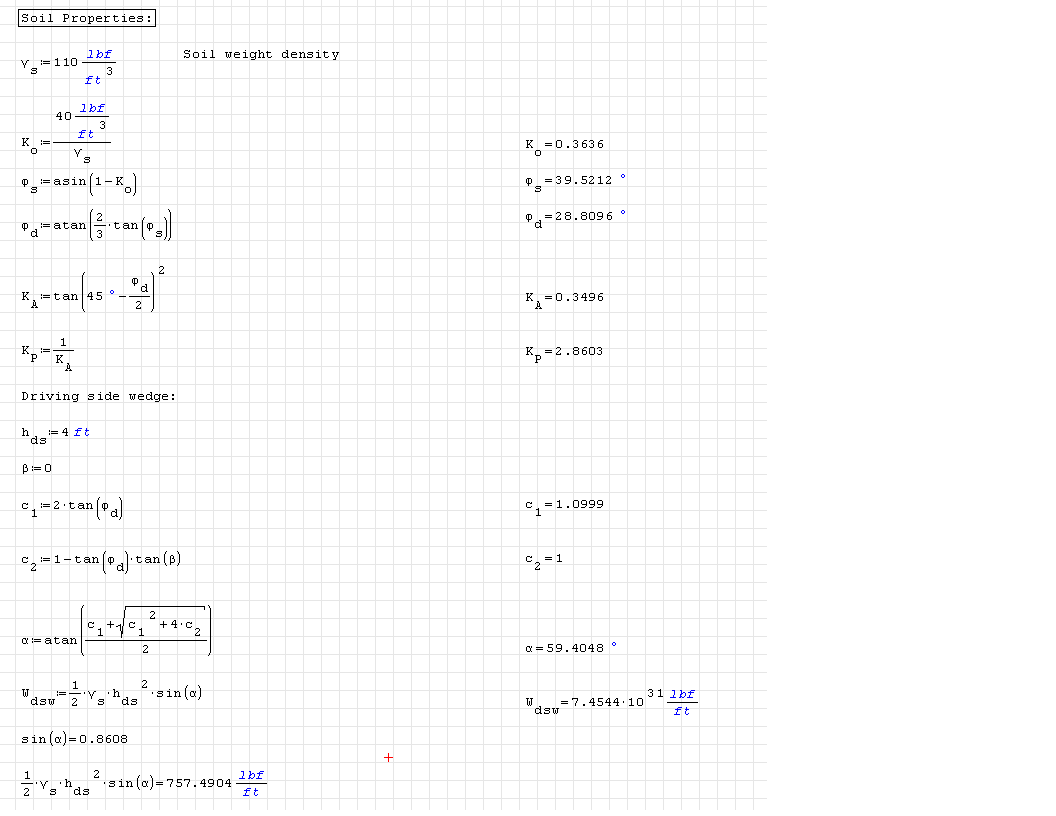

I've been using SMath (0.89) for about a year now and never experience this. Its why I alway put the result next to the equation to be sure I'm getting a reasonable result. The value of Wdsw is 10^31 when it should have been only 757. If I set optimization as Numeric I get the correct result. More reason to keep a check on running results. If I hadn't who knows what the final result would be.

This is one more example among others where the "Symbolic" optimization had problems with. I tried to reproduce it and the value of W.dsw is somewhat different than in your case.
[LIVE width=461 height=588]http://smath.info/live/?file=2711[/LIVE]
Here - "None" or "Numeric" will give the correct numerical value.
Someone on this Forum suggested having the option to set "None" or "Numeric" as default instead of "Symbolic". optimization. I suppose that this might be one of the possibility, until the fixing of this problem.
