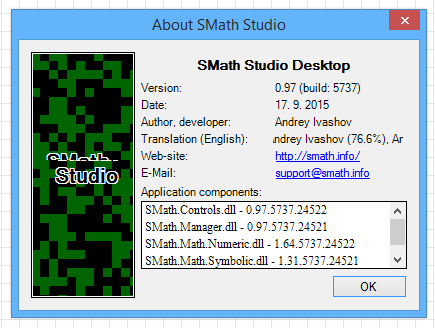

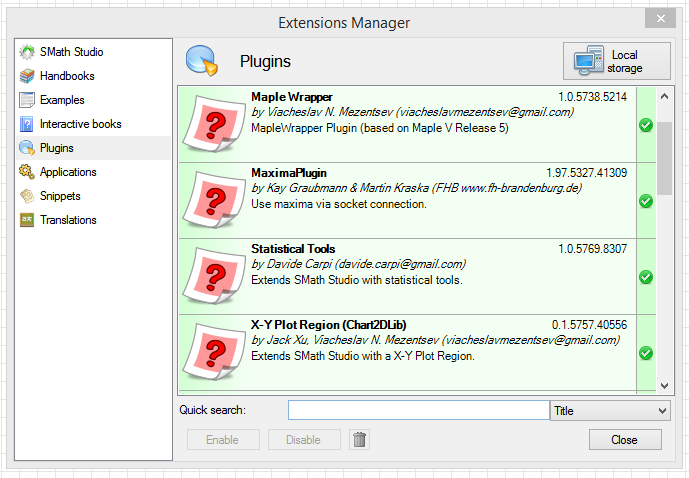

Hello.

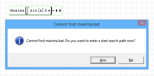

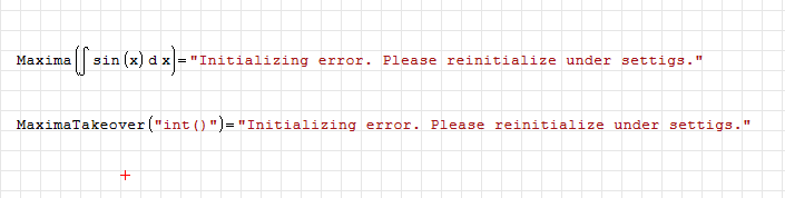

Maxima does not work in my SMath. What is wrong?
First use of Maxima function asks me for a path to maxima.bat, but there does not follow any dialog for to find the file...
Any maxima function gets an error. See images.
Thanks for answer
Regards Olik

Please make sure that you use the portable distribution with pre-installed plugins and maxima (see link in the signature).
It is a bit outdated but should work.
The distribution has been compiled precisely because installation and configuration of the plugin is a bit tricky.
If you really want to do it yourself, then have a look at the interactive handbook and the german pdf handbook (both to be found in the extension manager). They have sections on Maxima.

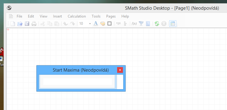

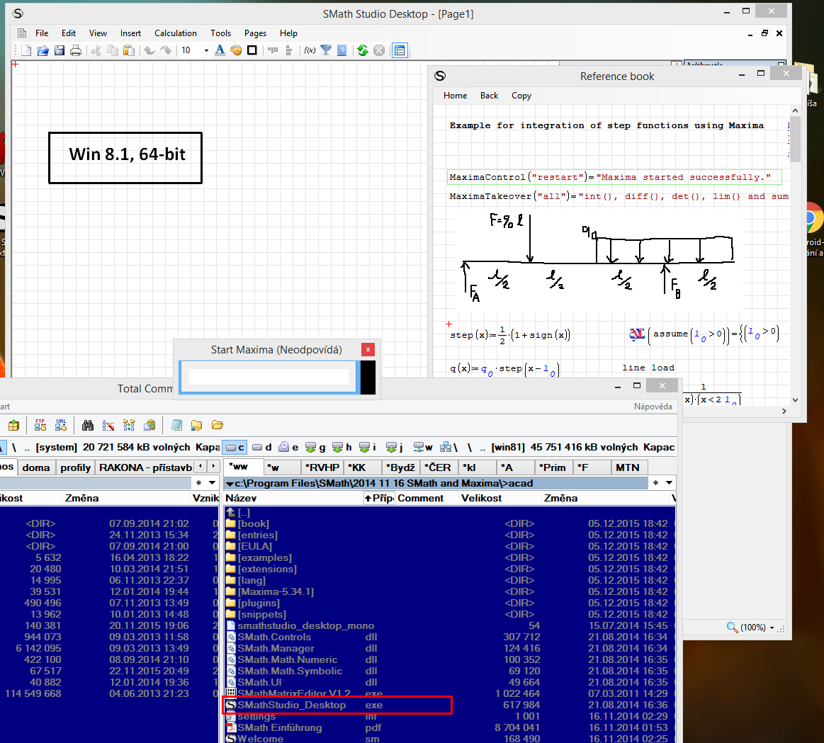

I downloaded and unpacked the portable version
(2014 11 16 SMath and Maxima\Maxima-5.34.1). I tried to set the path to maxima.bat or to execute a maxima command
( MaximaControl ("cleanup" ) = ).
All I got is a dialog "Maxima does not answer" & the rotating cursor... Do I have to setup something more?
Maxima looks so interesting, but I am always not able to run it...
Regards Olik

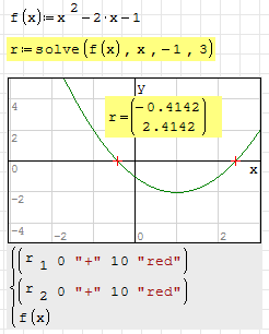

Your function has root = 1
Always plot before solving
"solve" for a single function is implicit of solving for the roots
so, your solve block is ill conditionned.
"Assign" ... Assign what ?
here is an example of good use.

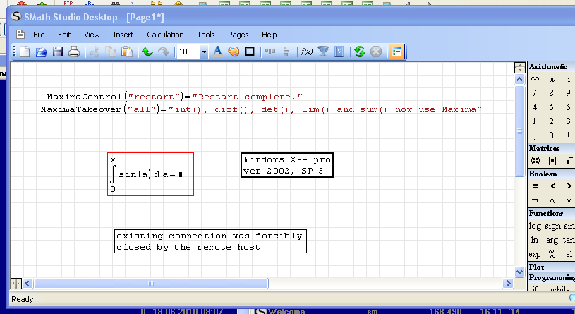

I tried to run portable with maxima on w7, w8 -- collapsed
and on w xp -- I could Takeover, but I could not evaluate int() function.
Sorry. I solved my problem using maple() function. It is not so nice ...
regards, Olik

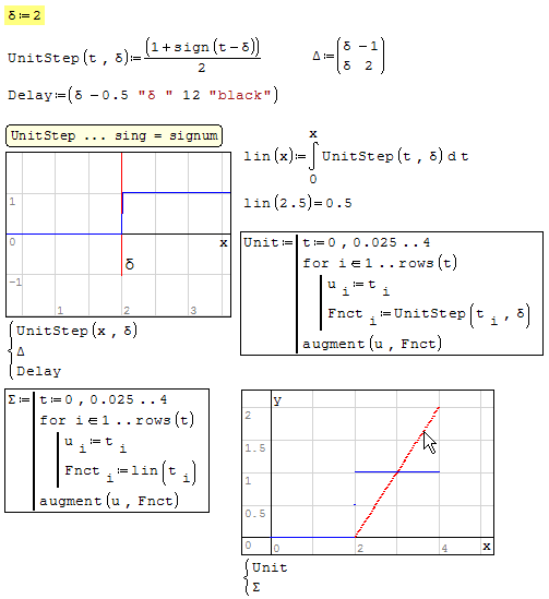

Honestly: I wonder why some Smath users pesist with Maxima ?
done XP [SP 3], just Smath
