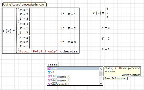

#4 Posted: 4/30/2020 8:42:33 AM
NDTM Amarasekera
NDTM Amarasekera
130 likes in 352 posts.
Using "cases" function.
cases_ex.sm (89.06 KiB) downloaded 1172 time(s).

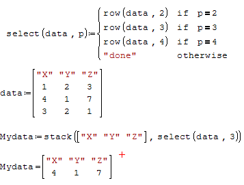

#5 Posted: 4/30/2020 9:26:22 AM
I will try this one
Page1 if_oterwise.sm (4.7 KiB) downloaded 1369 time(s).
