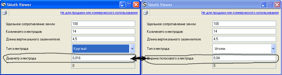

I'm a Russian engineer. We have a lot of calculations which, depending on the parameter chosen earlier, change the future types of data to be entered. For example, when calculating the ground: If the rod is a round data set one. And if you select a corner, then the data set is different. How to solve the problem of choosing formulas I found, but there is no input of data types.
I want to make a simple calculation with an output list of bar types, and below them is the data entry area, which will vary depending on the selected rod. Most likely this function already exists and is solved as an area, but I did not find an example. Help please an example or say there is such a functional?
The final calculation would be desirable to see in the form of a well-designed SMAth Viewer
Sorry for my english!

A new simple example is the question:
There are two formulas: the sum and multiplication
When selecting a sum in the viewer, only the parameter b
When selecting a multt in the viewer, only see the parameter c
Now I see both parameters, although one of them is not needed
Is it possible to remove one of the options depending on the choice?
PS: When I drink vodka with my friend Andrew, we will discuss this topic
#5 Posted: 7/14/2017 4:58:59 AM
Try this method:Answer1.sm (4.56 KiB) downloaded 1746 time(s).
neurosedd 7/19/2017 10:00:00 AM
#6 Posted: 7/14/2017 5:19:30 AM
WroteTry this method:Answer1.sm (4.56 KiB) downloaded 1746 time(s).
Thank you so much! This works for me. I would like to be more elegant, but this method is also workable.
I'm in the thread discussing the project:
I think that such an opportunity could be useful, especially in Smath Viewer. Maybe someone will develop it in the form of an additional module.
I see this as an area that already exists. Depending on the selected matrix element, the elements inside the region disappear and others appear. It is necessary to expand the possibility of the existing field.
This is important and convenient when the calculation is done for the SMath Viewer
