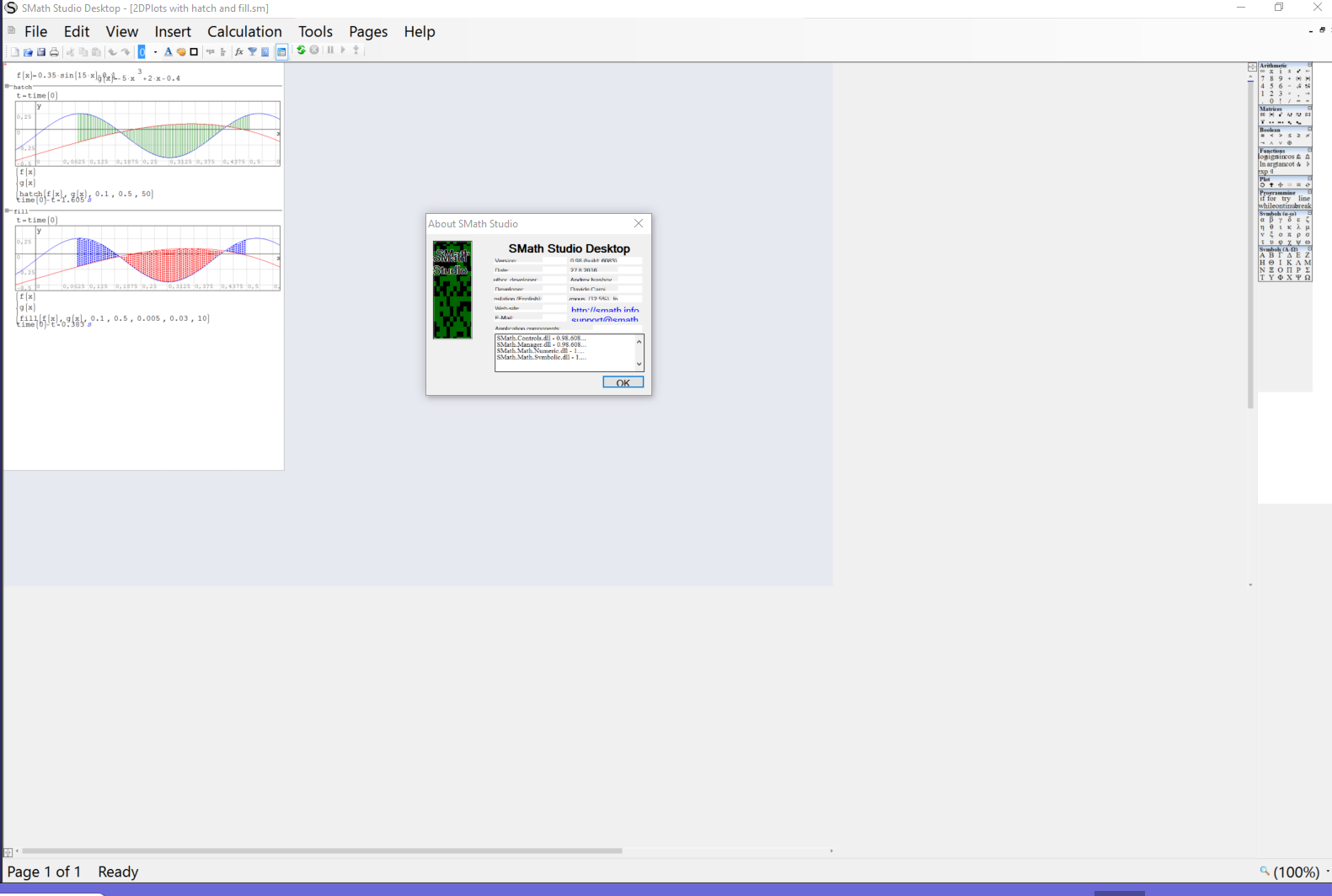

#4 Posted: 8/28/2016 3:25:01 PM
Jaan Praks
Jaan Praks
1 likes in 9 posts.
The last build (0.98.6083) broke something in screen scaling. Now in Win 10 high resolution screens (Surface 3 pro) the program is unusable, mouse pointer scales to wrong place, menu fonts are too big and toolbar fonts too small.
#5 Posted: 8/28/2016 6:09:58 PM
____________________________________________
I don't use those gadgets "Surface and the likes" . The original graph is Smath pixel size
not like Mathcad used to be ½ pica [6 pixels]. The original is 708 pixels wide 96 ppi.
Thus, once transferred on Surface 3 that has resolution 216 ppi , it will appear zoomed
down by a ratio of 216/96 = 2.25 ... appearing pretty small . Further, your screen shot
is from whatever transmitted and finally appears pretty blurred on the back 96 ppi PC.
To me, Surface goes no further than playing with cat fur or writting "Hello Grandma".
Smath is essentially not a CAD tool, i.e: not an SVG software like the "likes".
Your screen shot is zoomed down 2.25 ... pixels for pixels.
If you read your Surface back on PC 96 ppi, it should reappear like original.
If you would create something worth for the Smath community and transmit such a
piece of crap from Surface ... better attach a readable Smath document.

The problem was the Image Region plugin and after removing it, everything returned to normal. Curiously, this problem has never occurred with earlier builds in my Surface Pro. The screenshot was attached in original size. At lower resolution screens, it is downsized by the web browser and can probably look pretty horrible. This is the reason I use Surface: excellent screen. One can save the picture and inspect it in original resolution. High resolution screens are getting common and 4K is soon the monitor standard. I think it would be smart to keep Smath compatible with modern hardware.
#7 Posted: 8/31/2016 11:01:54 AM
Thank you for pointing out both the issue and the cause
Because plugins are loaded differently in this relase
Preloading assemblies to reduce first calculation time required on application start implemented;
We'll fix it.
High resolution screens are getting common and 4K is soon the monitor standard. I think it would be smart to keep SMath compatible with modern hardware.
I agree. BTW 4k is just the number of pixels, the issues are all about DPI/PPI different from 96.
