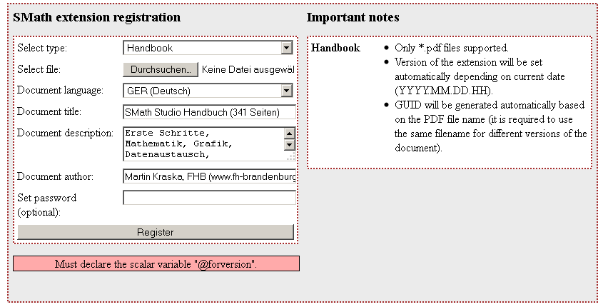

I can't provide new versions of PDF handbooks and of interactive books. In both cases, the web registration form complains that I
"Must declare the scalar variable "@forversion" "
However, there is no hint on how to specify this. I guess that this is related to the new feature for plugins, where the SMath-version can be specified, where these plugins should be offered.
Yet, the upload was successful, but the newly registered versions are not shown in the online gallery, thus not accessible for other users. Sorry for that.
#8 Posted: 3/29/2014 6:45:58 AM
1,361 likes in 2,275 posts.
Problem solved, new versions are available.
Thanks, Andrey.
