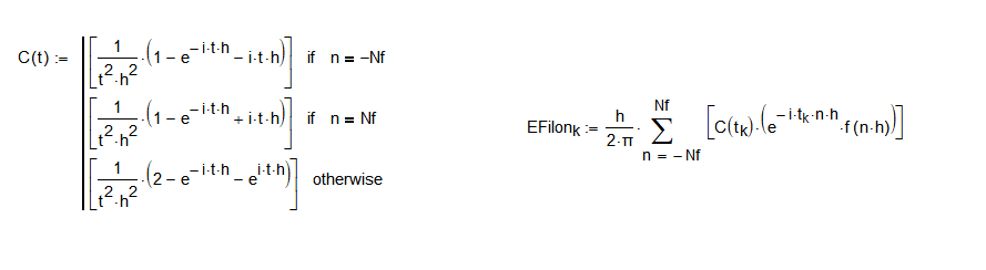

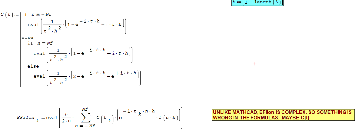

Can someone familiar with both SMATH and MATHCAD 15 tell me if these formulas are equivalent because I get very different results for each software. MATHCAD produces correct results and SMATH does not.
MATHCAD 15 Formulas:
SMATH Formulas:
Thanks for any help.

Use function cases() to define C(t)
C(t):cases(#,#,#,#,#)

Thanks much. I’ll give that a try.
