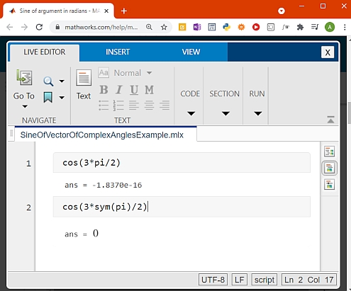

The same can be obtained in Matlab, in this case, using the sym command, which, by the way, changed its syntax very recently.

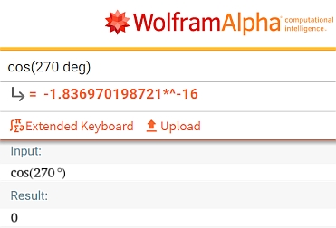

Also WolframAlpha has two answers for the same question, although in the end he opts only to show the exact value.
That is, the three programs coincide in giving something very close to 0, but not when the numerical answer is requested, and 0 or some expression equivalent to 0 when they are evaluated symbolically.

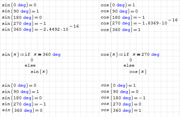

This seems to be a good solution since only 270-deg with cosine and 360-deg with sine seem to be an issue.
#12 Posted: 4/28/2021 1:30:04 PM
983 likes in 6866 posts.
Doing that is bug vs PTC Mathcad, Wolfram Alpha ...
The question is: why and since when CAS don't define result < 10^-15 = 0
