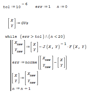

#1 Posted: 2/9/2024 9:27:16 PM
See please the attached file.Newton.sm (23.6 KiB) downloaded 1602 time(s).

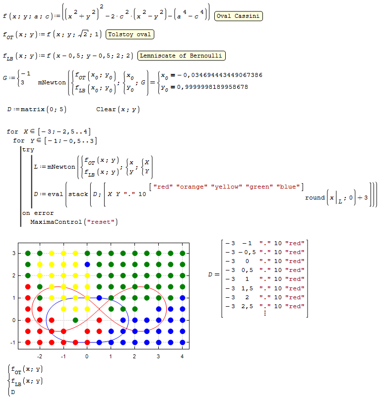

mNewton() from the Maxima plugin is another option. It also may fail for particular initial guess values.
mNewton.sm (16.22 KiB) downloaded 1629 time(s).
