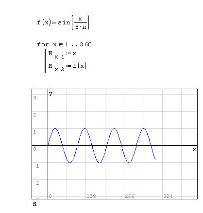

ok, maybe that is you want:

This could work. But What is the point of having the subscripts of x1 and x2 under the M. That may be a dumb question but i am new to this software. And I would have thought to type Mx2 in plot. why wouldn't you? You had just put M.
#6 Опубликовано: 12.05.2011 13:08:50
124 сообщений из 298 понравились пользователям.
Ok, M is a matrix where the first column are x values and the second column are y values. Observe that in "for..." cycle I assign values row by row to each column. The plot function plots the first column as "x" and the second one as "y".
