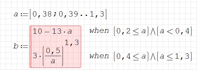

Hello. Please help with this task. Is it possible in a smath studio to find all the solutions for a by recording the answer through b
#2 Опубликовано: 19.05.2021 04:55:59
With Vectorization of "b"

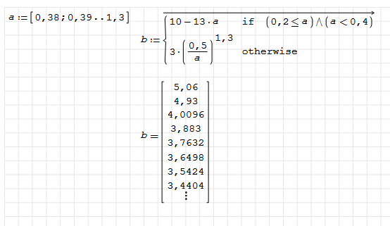

how did you write the equation and condition under the vector?SMathStudio_Desktop_CSbjjkGzCL.jpg

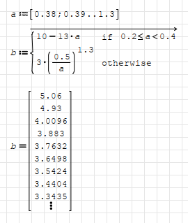

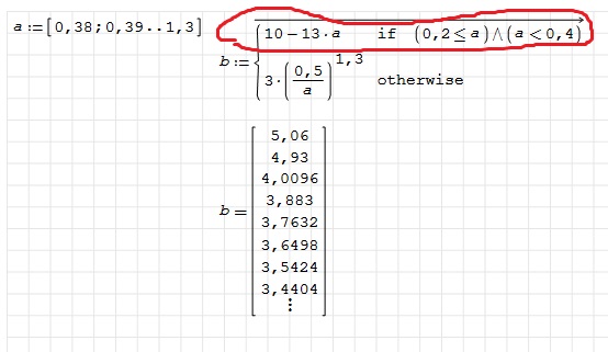

#4 Опубликовано: 19.05.2021 07:58:01
I used "Cases" which is a function of the "Custom Functions" plugin but if you didn't install it you could use "if"
vector_aa.sm (4,47 КиБ) скачан 1055 раз(а).
Thank you very much. what I need

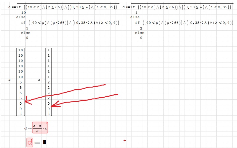

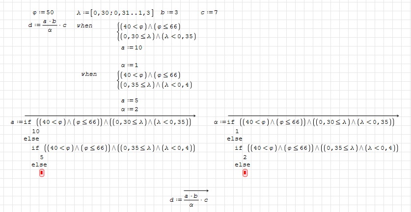

#11 Опубликовано: 20.05.2021 06:54:15
it's not easy to help you not knowing what you want to achieve. I do not understand if "alpha" has been defined and whether it is scalar or vector. If it were a scalar, you don't need further vectorization in the calculation of "d" as in the example I set you. With many "if" nestled reading is more complicated and I recommend the use of "cases"
vector_ab.sm (6,36 КиБ) скачан 1103 раз(а).

I'm sorry, I didn't specify all the values. I'll try to explain what I need.
I need to find all the values of "d" by a given formula, taking the values of "a" and "α" from a table in which there is a dependence of "a" and "α" on the values of "ϕ" and "λ".
I, by analogy with your example, decided to first find all the values of "a" from the table, taking into account all the variants of "ϕ" and "λ", then the same for "α".
and then just substitute all the sets of values "a" and "α" into the given formula and get all the sets of the answer "d"
I set separate loops for "a" and "α", found their values, and found "d", only the problem is that I need to finish the loop when my conditions are over

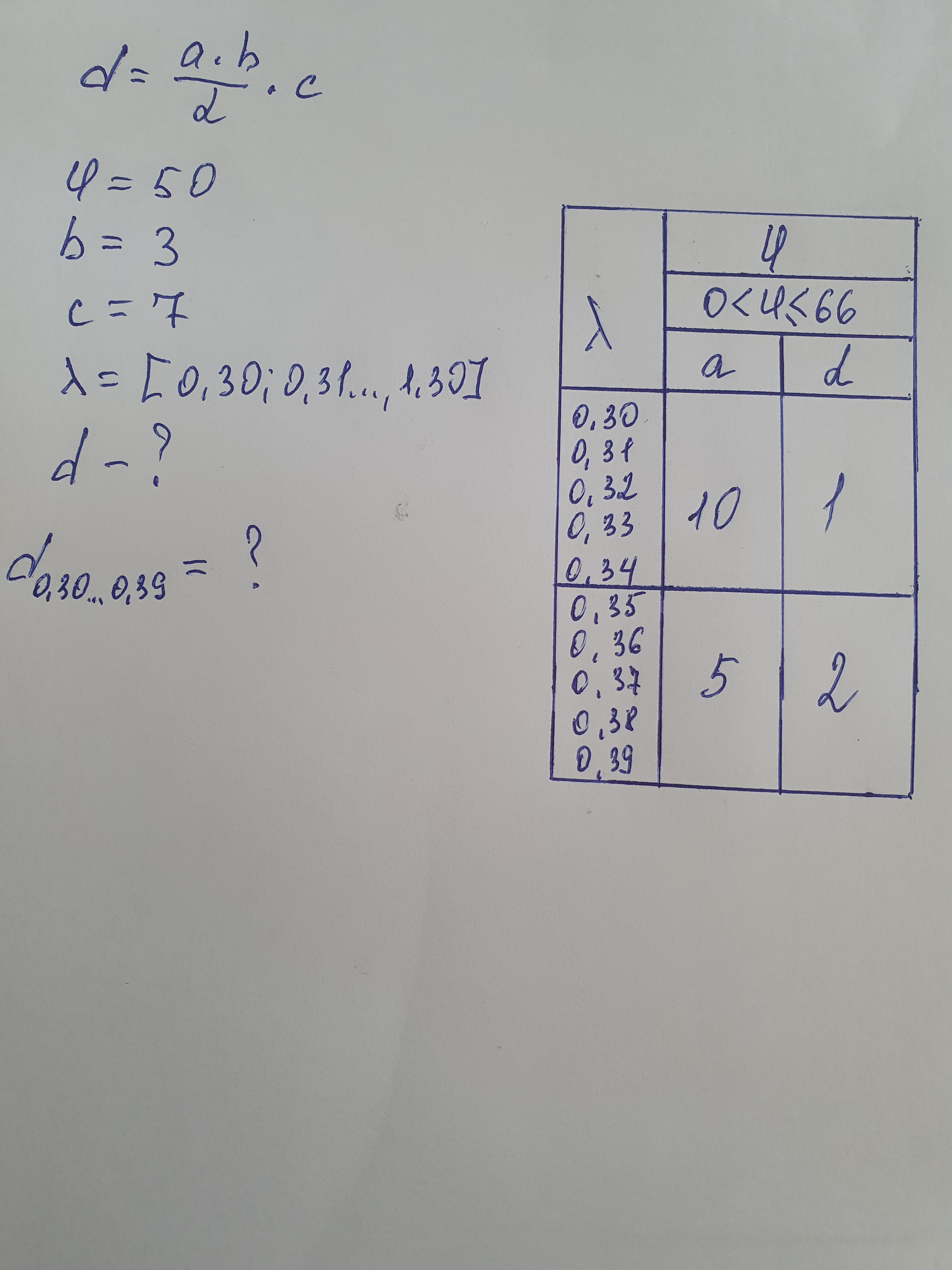

Hard to figure what you need from the blue ! i.e: w/o document.
part of the tabular data
#17 Опубликовано: 20.05.2021 09:51:43
*.jpg is not a working document.
Code my image in your version to make sure it works.
Attach in the forum ... specify + of what you need.
At this point, in-situ, you can define as many conditions
and range at will as well ... Smath Community will be there.

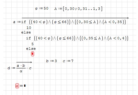

calculation.sm (12,59 КиБ) скачан 1053 раз(а).
I can't figure out how to stop the calculation after "else" for "a" and "α"
#19 Опубликовано: 20.05.2021 11:36:08
... fill-in the last argument of if/else.
As far as I could doctor ... check the Bolean.
calculation.sm (26,78 КиБ) скачан 1012 раз(а).
