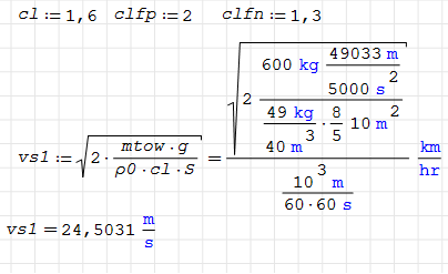

Hello, I'm trying to make a project in Smath, one of the requirements is that there must be shown what numbers am I substituting in my equtions.
I know you can change the optimalization to none to show the numbers, however this shows them as fractions and the fraction settings doesn't seem to do anything with it,
the result can be seen in image lower. What I want is to show the 49033/5000 as 9,81, which is how I defined it to begin with.
I would really apreciate if someone could tell me how to show those numbers in decimal form or how to do the whole thing in other way that would result in what I want.
Thank you very much in advance.

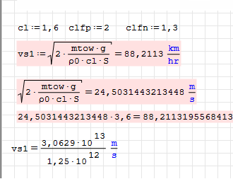

Wrote49033/5000
As you are using units, 49033/500=9.806600000000000
represents the true value of that constant in floating arithmetic.

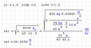

I think that changing the optimization to numerical is enough.
zatizeni_R1.sm (447,45 КиБ) скачан 1147 раз(а).

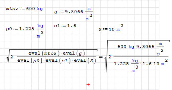

well, apparently the way of carlos is much more elegant.
Thank you very much Carlos, thats exactly what I needed.
Didn't know there even was function eval.
Really thanks.

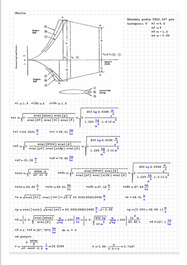

By same token, you can make the while loops more visible
... in green below.
zatizeni [pink_green].sm (458,16 КиБ) скачан 978 раз(а).
