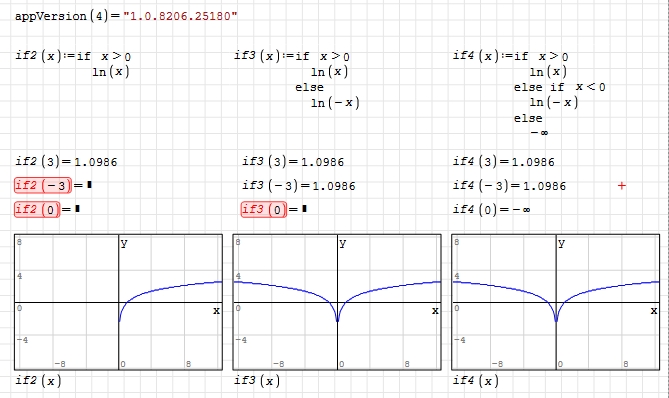

Since the new update in july i have a problem with the if(...) function. Now it looks like that (picture). I have reinstallated SMath, but the problem allready exists.
Is it an Bug?

Hi Thilo. Not a bug, but a new feature. use "," or ";" for write more arguments.
From https://en.smath.com/forum/yaf_postst23148_Stable--SMath-Studio-1-0-8238--22-July-2022.aspx :
"if(..) function extended to support any number of arguments more or equal to 2;"
