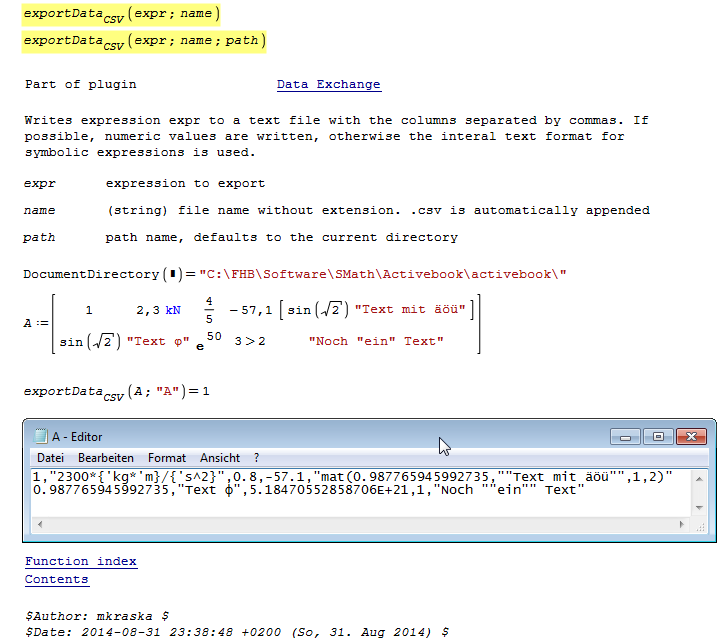

You can use ExportData.CSV() from the DataExchange plugin. It doesn't generate tab-delimited files. If really needed, you can replace the commas by tabs using some script or filter command.
exportData.CSV.sm (23,29 КиБ) скачан 1089 раз(а).
