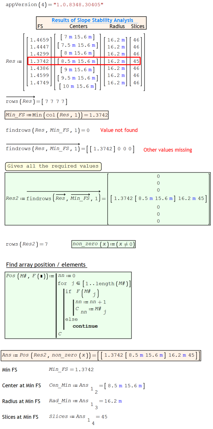

I came across a problem in the use of findrows() function when applied to a nested array.
The nested array is the result of a Slope Stability Analysis example.
Sufficient explanatory notes included.
However, I was able to get required values by some manipulations as shown.
Is there a better method ?

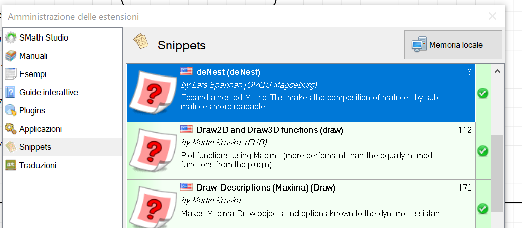

using the deNest snippet (found in the tools).
Findrows Problem_deNest.sm (20,09 КиБ) скачан 1382 раз(а).

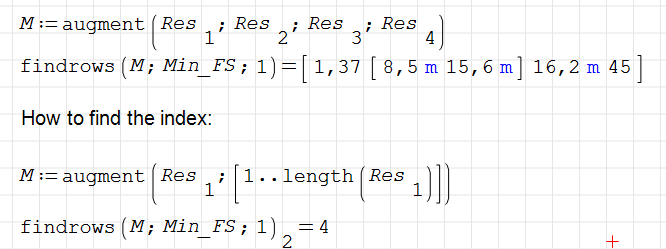

I'd perhaps just join the columns by augment() and then apply findrows().
Findrows Problem_Kr.sm (23,92 КиБ) скачан 1358 раз(а).

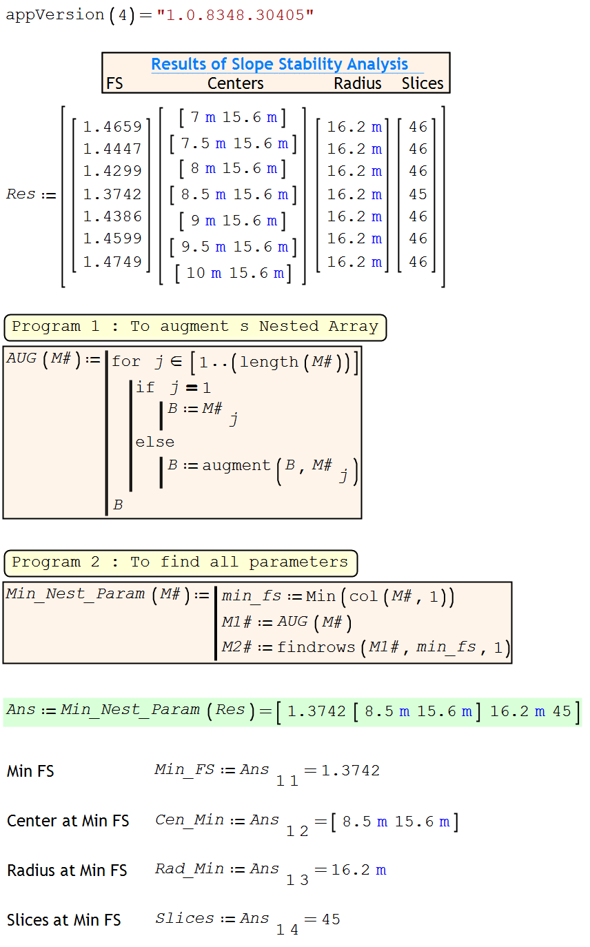

A revised program, based on mkraska's solution.
Findrows Solved.sm (15,49 КиБ) скачан 1428 раз(а).
