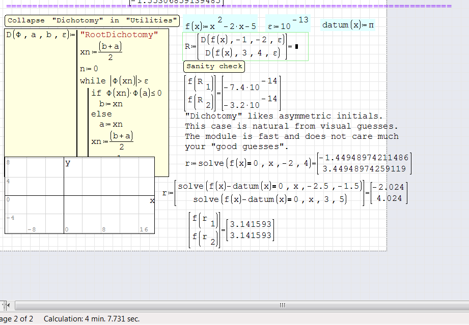

This Smath document is hot from bakery. A must to start getting used.
Inversing a function is also 'solving', from another Smath document.
Thanks Alex for your function x^1/3. It puzzled me a bit why it does
not plot in q(x)-g(x). Finally, eval(,) rescues the plot and enables
RootSecant to work fine, presented here as a "utility".
About numerical solvers for this type of application, everything has
been invented, even the square wheel! that runs flat on cycloidal road.
Why so many ? Because maths are so many, so much.
Enjoy, please post your "difficult solve".
Solve roots_solve RootSecant.sm (38,92 КиБ) скачан 1466 раз(а).

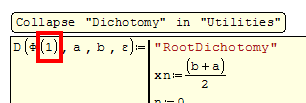

Davide Carpi 25.11.2016 19:49:00
Wrotedoes not evaluate
You have to change the argument Φ into Φ(1) in both the algorithms (RootSecant and Dichotomy)

Found the cause
In the original algorithm, functions is not passed by the argument (both in 5346 and the latest), because first argument is not declared to be a function (to figure it, you can replace first argument in RootSecant/Dichotomy definition with a non existing variable, like zzz, you will see the worksheet still works in the same way). The link with the functions in the worksheet is given by this definition, just below RootSecant:
![2016-11-26 00_39_01-SMath Studio Desktop - [Solve%20roots_solve%20RootSecant.sm_].png](/ru-RU/files/Download/GSCbK6/2016-11-26-00_39_01-SMath-Studio-Desktop---[Solve%20roots_solve%20RootSecant.sm_].png)
Here is the cause of the different behaviors:
- In SS 0.97, f(x) is kept as symbolical definition even if f(x) already exists, hence when you call the algorithms the function Φ(x) to solve in the algorithms is the last f(x) defined before the use.
![2016-11-26 00_41_12-SMath Studio Desktop - [Solve%20roots_solve%20RootSecant.sm_].png](/ru-RU/files/Download/C6Roso/2016-11-26-00_41_12-SMath-Studio-Desktop---[Solve%20roots_solve%20RootSecant.sm_].png)
- In SS 0.98, the definition stores the content of f(x), hence then you ask the algorithms to solve always the same function, bracketed in different locations (wrong bracket -> infinite loop).
![2016-11-26 00_48_02-SMath Studio - [Solve%20roots_solve%20RootSecant.sm_].png](/ru-RU/files/Download/7pCNDM/2016-11-26-00_48_02-SMath-Studio---[Solve%20roots_solve%20RootSecant.sm_].png)
