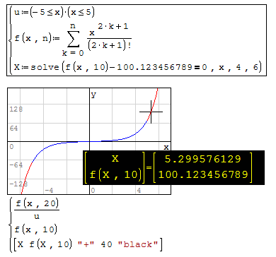

Is it possible to output all elements of such summation function (4) into an array of 1x40 vector ?

Hi. In the attached, two ways.
OutputSumm.sm (12,19 КиБ) скачан 1276 раз(а).

jdoe1
jdoe1
Thank you very much
