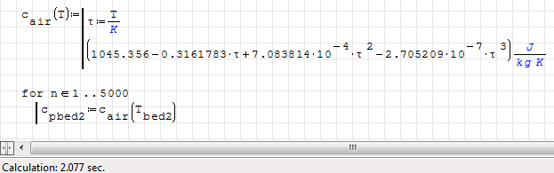

I'm not completely sure the problem is here... If I set both the optimizations to numeric (definition and for loop), I can make 5000 calculations in 2.0-2.1 seconds...

yes, I found out what my problem was. I only selected the last few calculations, i.e. those when it was getting really slow. However, I should have selected all calculations and changed optimisation to numeric...not only for the last few.
