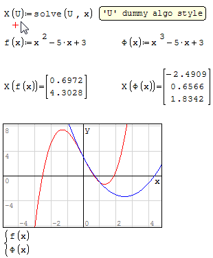

Useful for collecting multiple sets of solutions.
Solve Algo Style.sm (4,97 КиБ) скачан 1223 раз(а).

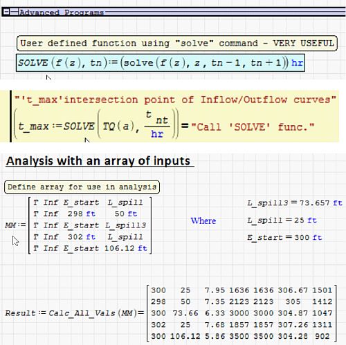

A similar approach used in the attached example.
Small Dams Flood Routing Ex-Program Method-Original-Simple3-R4.sm (1,3 МиБ) скачан 1357 раз(а).
