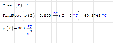

Maxima won't help because procedures aren't translated. In the given case, you could just switch x and y vectors in the interpolation to directly get T(rho).
Boeng_Kr.sm (113,14 КиБ) скачан 1488 раз(а).
