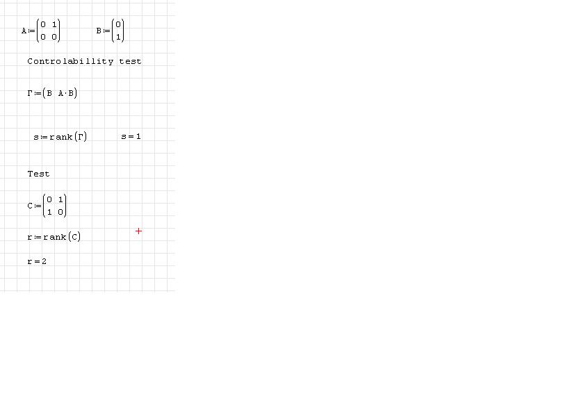

#3 Опубликовано: 21.02.2013 11:49:09
Ward Holloway
Ward Holloway
The comma's are from my Scilab equation, sorry about the confusion. It looks like my problem is in the way I calculate the matrix. Attached is a quick test I put together.
#4 Опубликовано: 21.02.2013 12:04:27
1 442 сообщений из 2 935 понравились пользователям.
You have made an error defining Γ
You need to use the augment() function; without this function you create a nested matrix.
BTW there is a bug because calling directly the rank function when the first matrix element is a nested matrix, a type conversion error appears.
regards,
w3b5urf3r
rank.sm (11,12 КиБ) скачан 1148 раз(а).
#5 Опубликовано: 21.02.2013 12:07:37
Ward Holloway
Ward Holloway
Excellent, thanks to both of you.
