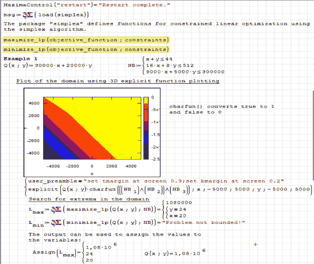

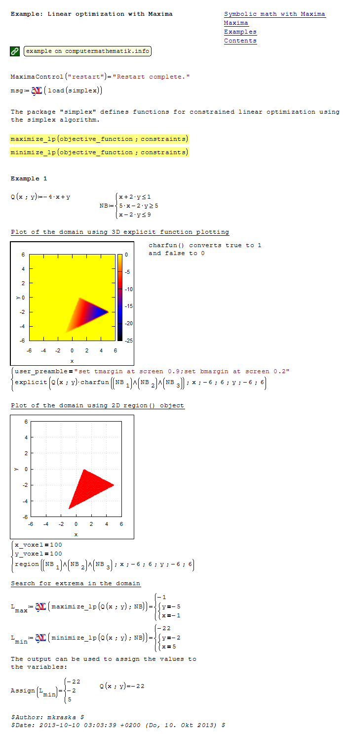

You can use the "simplex" package in Maxima (linear optimization)
See page Examples> Maxima usage> Linear optimization in the interactive handbook.
Example maxima linear optimization.sm (41,89 КиБ) скачан 1229 раз(а).
#3 Опубликовано: 19.12.2017 21:12:22
How will you go about solving following problem in Smath
Maybe plot the problem 1rst ?
Next solve solely with Smath, whereas Maxima is not component of stable 6179.

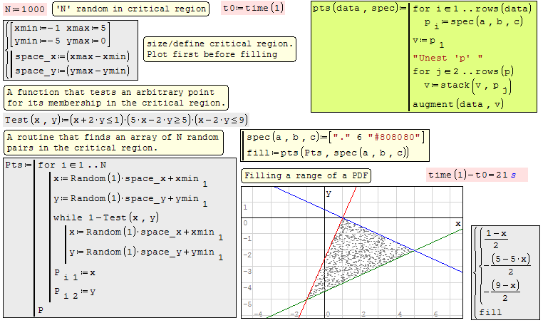

#5 Опубликовано: 20.12.2017 11:59:15
Thanks for the answers Jean would you be kind enough to attach the .sm file too.
Here is + some extra stuff. Maybe there is way to draw an inscribed 3D ?
Solve GivenFind Critical Region Copy.sm (39,35 КиБ) скачан 1245 раз(а).

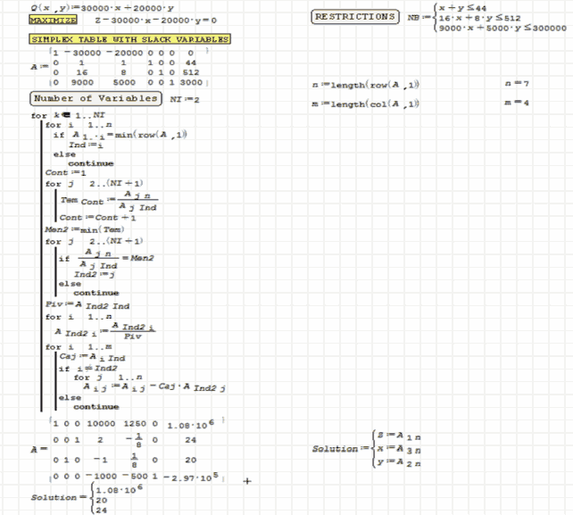

Using Smath Studio with Maxima and the example of Martin Kraska.
Metodo_Simplex.sm (52,26 КиБ) скачан 1258 раз(а).
#7 Опубликовано: 21.12.2017 15:27:26
CBG
CBG
Here is a small and simple Simplex algorithm without the use of the Maxima function.
Small_Simplex_Algorithm.sm (16,35 КиБ) скачан 1289 раз(а).
CAUTION: The algorithm is NOT TESTED, but it works well for this example.
It is necessary to refine it so that it work in all cases.

#8 Опубликовано: 21.12.2017 16:10:07
Thanks Carlos for the "Simplex algo"

CBG
CBG
A little Simplex algorithm improved
Small_Simplex_Algorithm_Improved.sm (88,5 КиБ) скачан 1227 раз(а).

CBG
CBG
I'm sorry, I found a bug in the Simplex algorithm.
Now it's fixed.
Small_Simplex_Algorithm_Improved_2.sm (135,66 КиБ) скачан 1252 раз(а).
#11 Опубликовано: 22.12.2017 10:12:27
That huge number in the program, can be replaced by ∞ [Smath machine number]
RemToDo => check vs Mathcad
First A[i ... badly indexed.
Small_Simplex_Algorithm_Improved_2.sm (140,42 КиБ) скачан 1268 раз(а).
CBG 22.12.2017 12:54:00
#12 Опубликовано: 22.12.2017 12:57:52
CBG
CBG
Thanks Jean, Now we just have to continue testing the Simplex algorithm, to identify possible faults.
regards
#13 Опубликовано: 22.12.2017 13:38:07
I have tested only this one => 1/1 Mathcad 11
Gorgeous, hope for more good !
Undocumented Copy.sm (25,63 КиБ) скачан 1304 раз(а).
