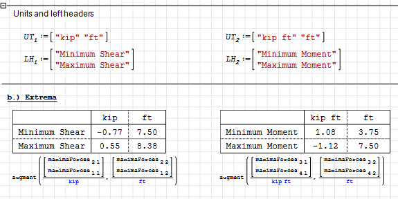

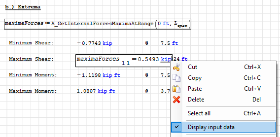

Hi JC. Thanks, very useful. Just as very marginal comment, you can improve how to show the extrema results. Instead of write the results, you can automate that in various forms. For example, hiding the input data, like this
or using the table plugin
Mark R Harris 11.12.2022 18:57:00, NDTM Amarasekera 11.12.2022 22:56:00

Hi Alvaro,
Yeah it is better to put results in table format Thanks for this.
