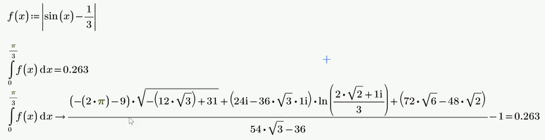

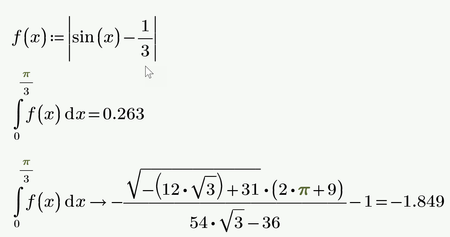

Why SMath studio does not give at least the correct result which is 0.263 for this integral?
Mathcad Prime 10:
-1.849 result is comming from symbolic result calculation, which is wrong in this case, but numeric result 0.263 is correct here also in mathcad prime 10.

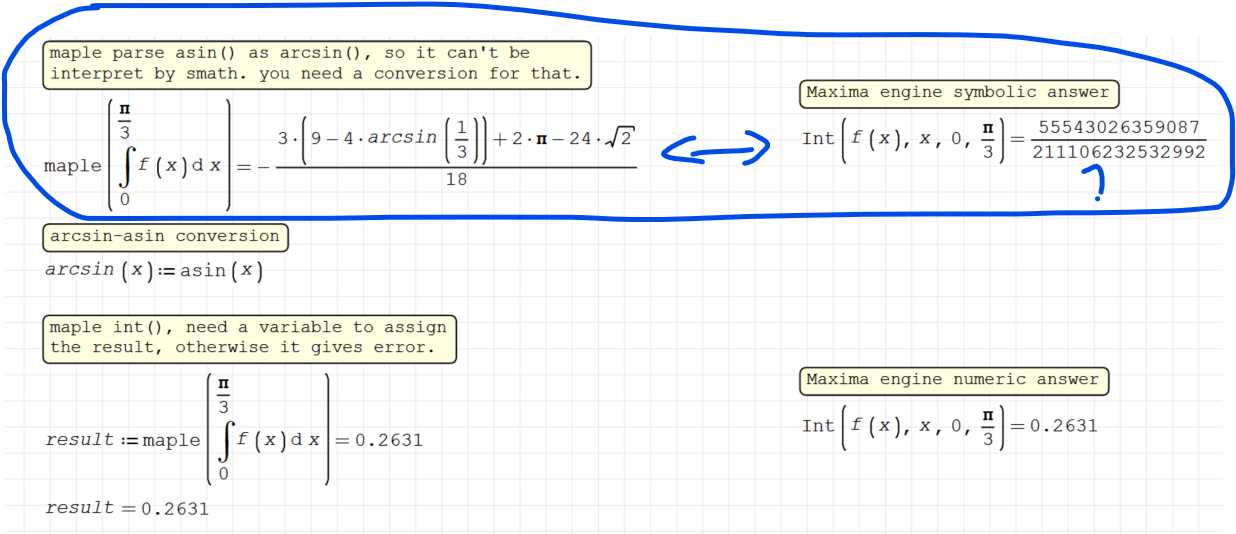

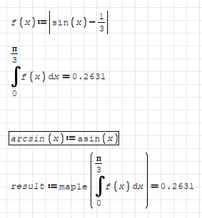

You must clear previous results (implicit definitions). If you do not, the task statement may change. To be sure, do each check separately in a new document.
maple-int-arcsin.sm (7,66 КиБ) скачан 1745 раз(а).
#4 Опубликовано: 14.10.2024 18:47:14

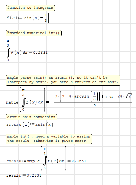

It gives correct results, even with embedded or maple.
You need to change arcsin() function to asin() however.

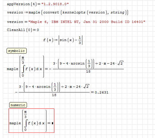

Could you post also the worksheet? As I do not know why my function arcsin(x) definition is not taken into account
Here it is, regards
int-embedded_maple.sm (6,97 КиБ) скачан 1731 раз(а).

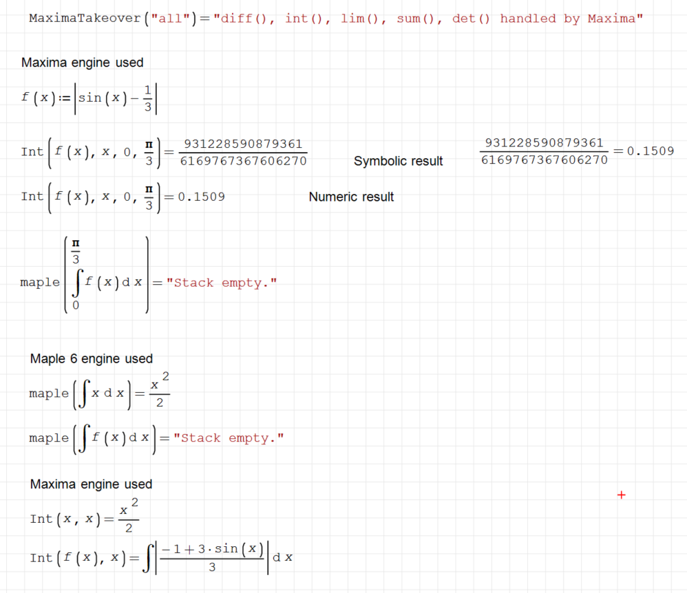

I see also the difference between Maxima engine and maple version 6 engine (in symbolic answer). With maxima engine the result is more a rational approximation of an irrational result. I would expected something similar as maple engine give when evaluating integral symbolically.
#13 Опубликовано: 15.10.2024 16:00:37

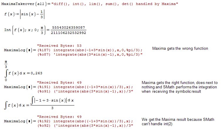

Maxima can't handle the integral. It returns a slightly modified symbolic representation. This is hidden by SMath postprocessing of the symbolic results (which doesn't seem to be suppressed for Optimization> None.
There seems to be a problem in preprocessing/translation when using the Int() function.
Worksheet20.sm (7,27 КиБ) скачан 1684 раз(а).
