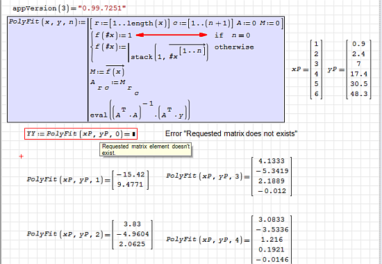

That's my solution
- to separate the functions from matrix building,
- to use vectorize for speed
Apparently, the function f(#x):=1 if n=0 has a problem?. Or is it redundant?
For values n>0, the "otherwise" condition yields correct results irrespective of values in "if" condition.
Please check.

just put the 1 into a 1x1 matrix. That's all.
(And if you want to use units with the X Vector, just remove the eval and evaluate symbolically.)
Hi
Still the same error when n=0.
Better if you can post the SM file please.

Sorry, I didn't realize, that vectorize behaves unexpectedly (to me), when the function does not include 'x'.
So I changed f to f(x):=[1+0*x] and now it works. The file is attached.
PolyFit.sm (11,92 КиБ) скачан 1281 раз(а).
I would expect the results of g and h to be the same, and to be a 3 items long vector.

Hi
Now I get same results as yours.
But the result (19.0833) of the Polyfit() function when n=0 ----> Does it have any meaning?
I have no idea. I was only testing it for all possible conditions..

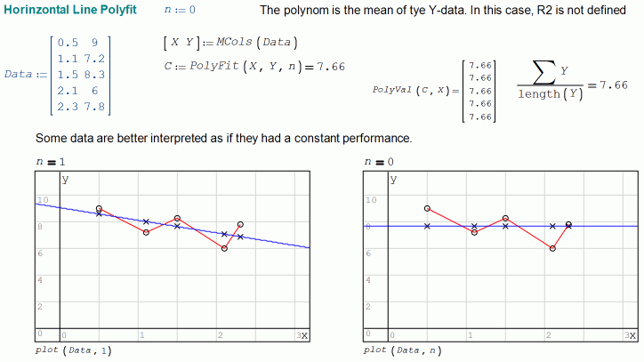

Hi. This is in case you want to interpolate with an horizontal line.
PolyFit.sm (159,33 КиБ) скачан 1322 раз(а).

sergio 12.12.2019 16:12:00

NDTM Amarasekera
NDTM Amarasekera
Thank you, Alvaro.
