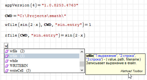

You can use wfile(3) and rfile(2) from Mathcad Toolbox plugin.

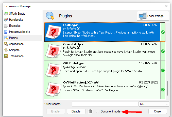

Microsoft Excel for example is a much larger and commonly used program that allows for the same with only a single "enable macros" toggle.
We could do the same, withing the plugin that carries these file manipulation functions, have a toggle that enables these functions.
In this way, a user is not exposed unknowingly to these functions.
Similar to the way we enable document mode.
